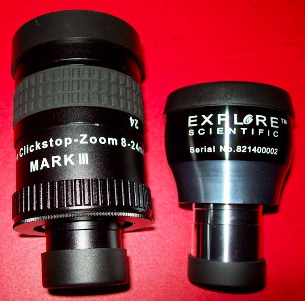

Short answer, yes - the Baader Zoom Mk III is optically good.
Some time back when the Baader Hyperion Zoom had just begun to make waves (I have both the II & Mark III versions)
L-R Baader Hyperion II & Mark III 8-24mm Zoom
brought my zoom to a local star party where several astro veteran buddies were in attendance and had them try the zoom - their reaction was identical, wow - and this is a zoom? They were very impressed by its optical performance, in the same way that I was wowed the first time I tried it and instantly became a convert.
With regards to ES82 eye relief, yes, the ER is a bit short on the ES82 and I've compared the ER of the ES82 vs Baader Zoom Mark III:
Mark III Zoom and ES82 14mm (mushroom version, same ER specs as the current ES82)
The Baader Zoom definitely has more ER and is more comfortable to use than the ES82, and will rate the zoom's ER as being not too long nor too short, just right and ergonomically pleasing to use for extended viewing sessions. In fact, have come across a post in SGL about the Baader Zoom's ER, to quote:
