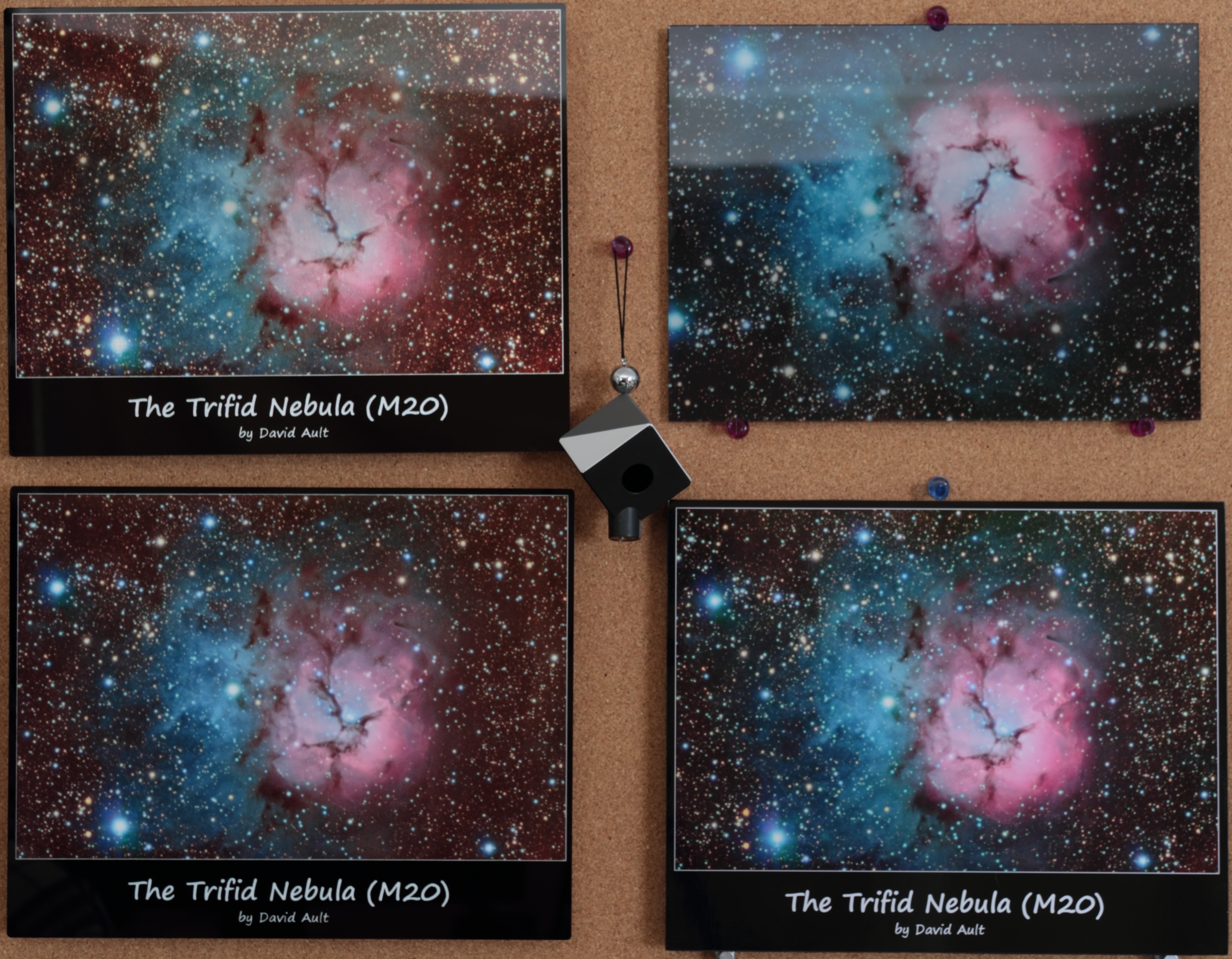

Here are the prints I've done.  I decided to add the border and text after getting the first one back and it looking somewhat bare.  I did this fairly quickly and it looks like I over exposed it a bit as all the images look brighter in the middle than they do in person.  The two pictures on the left are the Adorama metal prints, the one above is the 'allow the metal to show through' version.  It really is much darker than the others and only looks good in very bright light.  The upper right picture is from FractureMe and the lower right is from DeepSkyPrinting.
You can see the full resolution version here.
As a reference, this is the image I sent to them:
Visually, the Adorama metal print (without the metal showing through) was closest to what I expected.
David

Thanks for the post Adam.  Looks good from the 20' view, maybe not so much up close.  I wonder if we can't start a sticky, solely with a quick review, company used, price, and type of print for people's reference.
That's a good idea Josh.
Very interesting topic.  I've been doing my own analysis of different print houses and techniques.  So far I've tried fractureme.com (print on glass similar to the acrylic method that Adam tried), deepskyprinting.com which Warren mentioned and adoramapix.com for metalic prints (I've tried both the white and silver techniques).  I'll have to take a picture of them all together so everyone can see how they compare.
In the meantime I can give you some verbal feedback:
The fractureme print has the same banding issue that Adam has with the acrylic print.  I contacted them and they seemed to think that it was a normal part of their process and is normally not visible due to the higher contrast in most terrestrial photographs.  It's contrast and detail was also very poor.  It was definitely the worst of the 4.
The deepskyprinting print had the best detail and contrast.  The saturation seemed to have been pushed a bit too much for my tastes and the black level was a little too low.
The adorama metal prints were the closest to what I see on my monitor (which is calibrated).  I did find out that if you proof your image with their ICC profiles and include it in the JPG data they will use it when printing.  They will not use any other profiles, so the profile in my image was not utilized, which surprised me given how closely they matched the monitor.  I did get them to send me a proofing profile for the metal prints, but for some reason I can't get it to be used as an embedded profile when I write the file.  A small amount of detail was lost, which I guess means I need to print it a bit larger and stand a bit further back ;)
The white print was excellent and it almost seems like you are looking at a glass surface.  The silver print allows some of the metal to show through, but I really didn't like what this did to the contrast and saturation of the image.
David Ault
I appreciated David's posts as well.  This has been one of the most informative threads I've read lately.

Wow, I've never had Deep Sky Printing blow out the core of something like your example shows.
Warren,
I tried my best, but I did get the image of the prints a bit over exposed and I didn't have the time to try again, so it's not as bad as it looks in that picture.  That shot is probably fine for comparing them to each other, but not great for understanding what the prints look like on the wall.  I think both the Adorama metal and DeepSkyPrinting prints look good and neither of them have the core blown out.  I think the DeepSkyPrinting version may also be a bit more washed out than the others due to the position of the light source.  If I have some time this weekend I'll try it with a diffuse light and get the camera square to the prints.
David

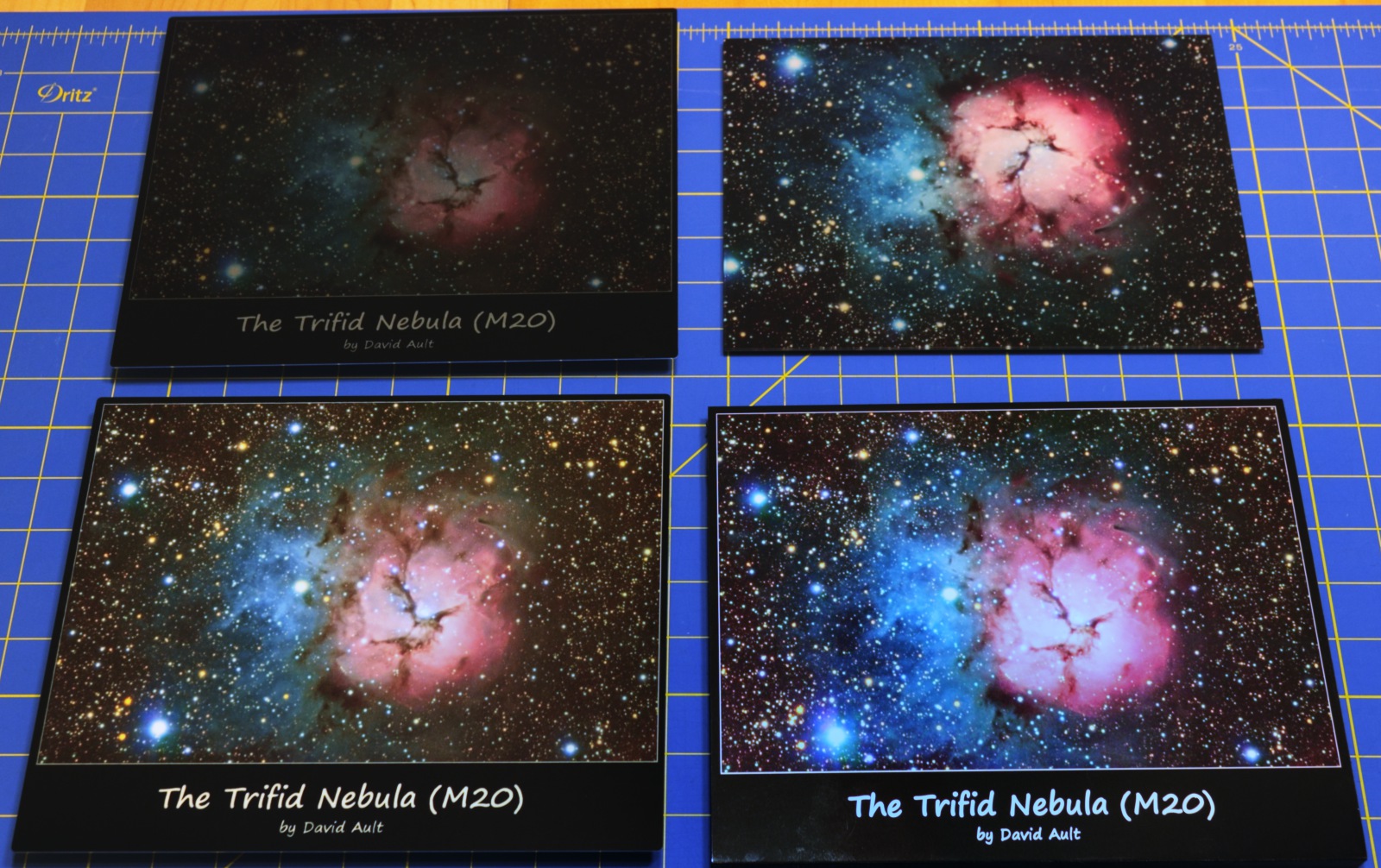

I had a little time today, so I setup to try to take a better shot of the prints:
You can find the full version here.
David

I actually considered putting it off to the side and then cropping it out of the final frame, but I figured, what the heck, this way everyone can check the color balance!
David

That does look better!
