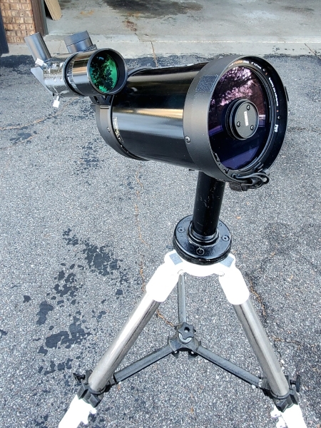

Good morning-can you add my C-5 Tele F/6 to the registry?  I posted it a while back, but here it is again:
C-5 Side View with S/N
IMG 8022
C-5 Spotter
SN 1852
Jim Duke
Edited by flyboyu777, 27 January 2024 - 09:25 AM.

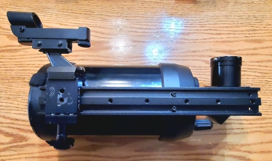

My C5 nameplate
Hi, all. I have a C5 that I inherited from my great uncle. It has serial number 31038 4 -- looks like the fork and base are sand-cast.
On another note, I do not have a tripod or wedge for this scope and I'd really love to have one. I haven't been able to find any recent classified listings for these. Does anybody know where I might acquire them? Thanks!
Edited by bdrell, 22 April 2024 - 05:38 PM.
