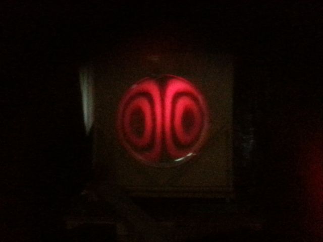

#19 rik ter horst
rik ter horst
  • Posts: 466
  • Joined: 01 Nov 2010
  • Loc: Zuidbroek, the Netherlands
Posted 16 October 2015 - 08:45 AM
Interesting thread this is! You obviously like challenges ;-)
Also inspired by the work of Mel Bartels I started building a 16 inch F/3 dobson with a 19 mm thick, or thin ;-)  slumped mirror (plate glass) as an experiment. This mirror now is in its final stage and needs some last corrections. Despite the mirror not being aluminized yet I only can say that I'm excited about the views it delivers when mounted in the test-scope built earlier by Geert Kwast, a fanatic local telescope maker. Equiped with an ES coma corrector it delivers a wide, totally coma-free field of view. I was quite surprised to be able to separate each individual component of Epsilon Lyra not only in the middle of the field but also almost right to the edge with a 13 mm Ethos ! And all these observations were done comfortably seated....
Below the mirror in its test-scope. I'm working on hardware now and will post some more pictures of it later.
Have fun with this project Tom!

<p>((over the years (particularly Caustic and Ross null tester) but also make better use of the star test. I ))</p>
<p>&nbsp;</p>
<p>Got it up to a full polish and bring it to delmarva next march.</p>
<p>The AC is the most qucikest way to test precisely.</p>
Sorry, but I have tried to parse this several times now, and I really don't know what it means.
Don't worry if you don't understand. It happens sometimes on this forum. It's a New Jersey dialect that Danny sometimes uses to speak in code to other NJ ATMs which, I believe, only they can understand :)
moudre votre miroir pour un vernis plein.
prendre votre miroir pour delmarva Mars prochain
en utilisant l'auto-collimateur, vous serez terminé en trois jours
