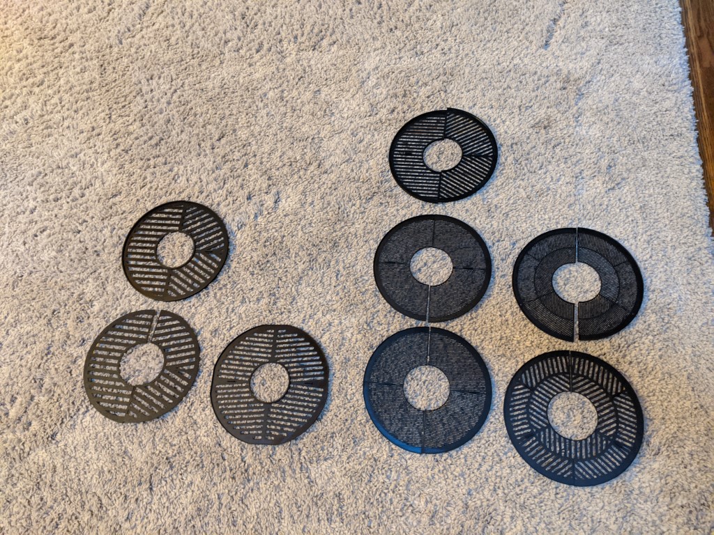

See, here's the thing (and the reason I latched onto this thread). I bought this OTA 2nd hand and I've never been happy with the corners. I can align the secondary mirror and get the center stars nice and round, but I've never got the corners ones perfect. So, I bought the Hotech and aligned the corrector plate. Thing is, it's all the way over to one side in order to pass the Hotech alignment procedure and my field curvature went way up compared to when it was mechanically centered. The stars are very much improved however.
I have also gone down a rabbit hole learning and understanding masks and mask design. I've got Bahtinov's, Carey's, tri-Bahtinov's and hybrids for each focal length. Here's my collection.

  Wow, that's a lot of masks!
  I really don't have any advice as to how to fix the problem. I think half of it is identifying the problem and the other half is figuring out whether it is worth fixing. I certainly hope that the problem has been found.
That's indeed a collection :)
Do you have a favorite? When it comes to results and/or ease of use?
Yup. Carey mask. Things I learned on that journey:
1. Smaller slots make a huge difference. Smaller the better.
2. Thin is in. I settled on 1mm thick.
3. I printed Duramic PLA+, eSun ABS+ and Inland PETG. I settled on plain old PLA+ for ease of print and durability.
4. Rounded corners do indeed make a difference. The spikes are sharper and more well defined.
I rewrote the Bahintov mask SCAD to produce rounded corners and either Bathinov or Carey masks by specifying the angle for both left and right halves. I had to call in help from my math brain son for the trig on that project.
  • meegja likes this
