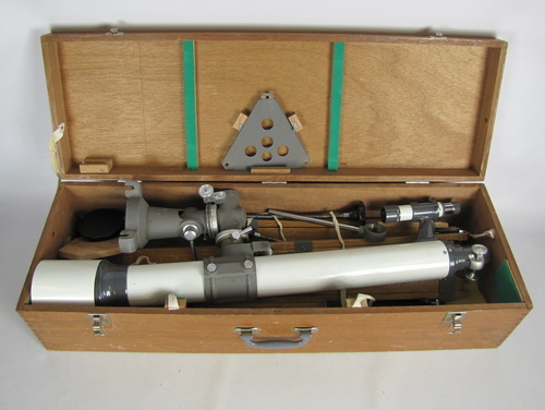

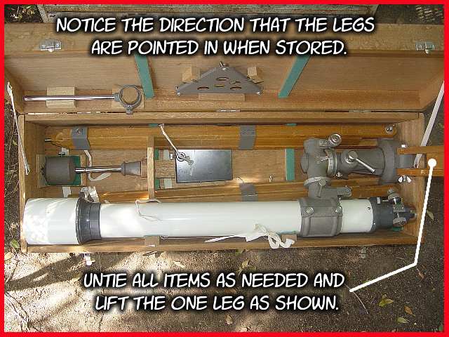

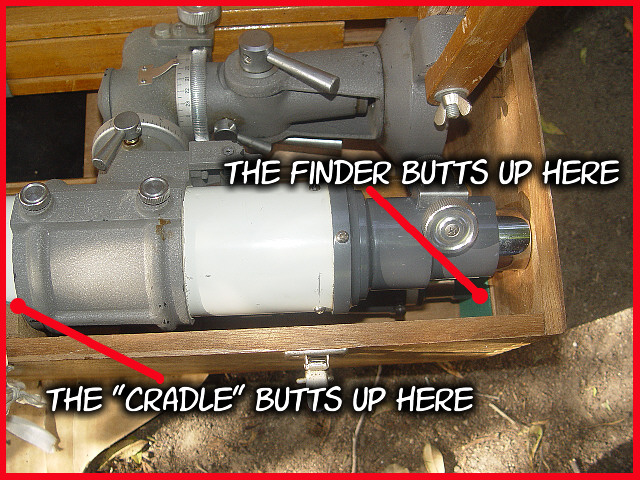

1) Does anyone have a pic of one of these packed into the box? Try as I might, I can't seem to figure out this puzzle. I've searched ebay and here for pics to no avail.

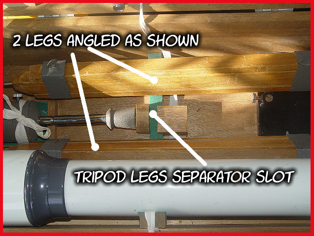

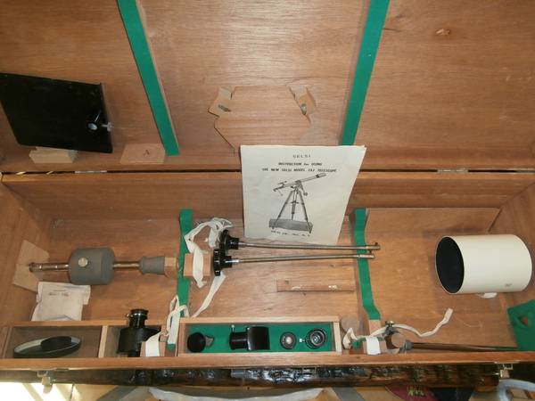

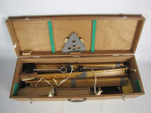

Sorry, I don't have a very good photo showing the Selsi 247 packed correctly in the wood box, but here are a couple showing some of the parts stored below the telescope, mount and legs which I believe would have be placed in the box as an assembly with the legs inverted. There may have been a triangular wood block to wrap the tripod legs against when the assy was stored in the box. See ref photos below.
This was common way that many scopes from the late 50s and 60 were stored before the use of Styrofoam.

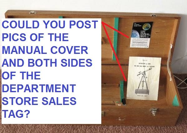

Also could you post or PM me a photo of the cover of the manual and also both sides of the department store tag. See marked up ref photo. Thanks
BTW, the gold oval PASSED JTII sticker on the focuser housing dates your scope to the 1966 thru 1972 time frame. Based on clues I see compared to a few others I have documented, I'm thinking your scope is closer to the 1972 time frame.

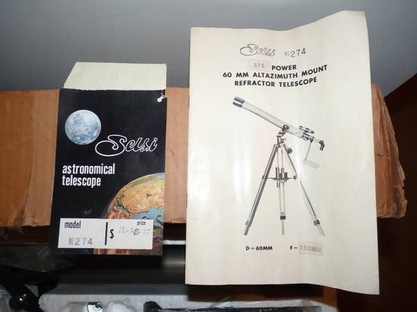

Thks for the photos!
I would bet that the scope was purchased around that March 1971 date. Backed up by the gold PASSED JTII tag 66-72 and matched my guestimation of it being closer to the 1972 date.
The location of the finder on your scope is on the focuser housing as opposed to the tube which is what is shown on the manual cover. All the older Selsi's have the finder on the tube. There are even 247s that are just a few years older than yours with the gold JTII tag that came with the focuser still on the tube. They also still have the objective cell engraved as yours does not. So that tells me that around 1971 or a little earlier, Selsi revised a few things on the telescope near what may have been the final version of the 247. Also your scope looks like is had the darker gray color of the focuser and obj cell, again what Selsi used on their 1970s scopes.
You'll notice that the name Selsi with it trademark inverted check mark on the focuser name tag is what Selsi used going back to the late 1950s IIRC.
Now look at the department store tag which has the revised Selsi font....more of a 1970s artwork font is what it reminds me of. Selsi must of been switching over their name logo around the 1971 time frame. You'll notice the same change on their binoculars as well.
Here is a dated 1977 Selsi 274 with the same type of department store tag for reference.

What struck me as odd & old was the cradle.  I thought this style went out of use in the 60s.  Did some makers keep it mainly for folding & storing the scope in a smaller case?  Or, did they have excess from an earlier run, and used that up?  I like it on my SS151 - but that metal brake hasn't fallen out (yet) at night in the yard...

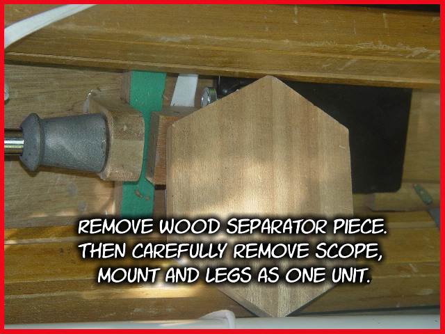

I really enjoy the "origami" aspect of these type of scopes,
origami as first mentioned by Bill Griffith in Post #51 at:
http://www.cloudynig...efractor/page-3
But in my experience it is really awkward, and a big challenge,
just removing, and re-installing an "origami" scope, especially
the heavier ones like this 80mm Selsi, without smackin' it a bit.
It's Bang, Zoom... long before you get to the moon Alice:
https://www.youtube....h?v=98qw86DsdZ0
I didn't have to struggle much figuring how to pack this 80mm
Selsi, due to some earlier puzzlin' with other "origami" scopes.
But... getting to this thing was a real pain as it was the bottom
layer, of a stacked, seven-layer, "Woody" (wood box)" stack.
Them 60mm Lafayette's are heavy suckers I tell ya'.
:tonofbricks: Oh,the pain, the pain. :gaah: Hope this helps?
