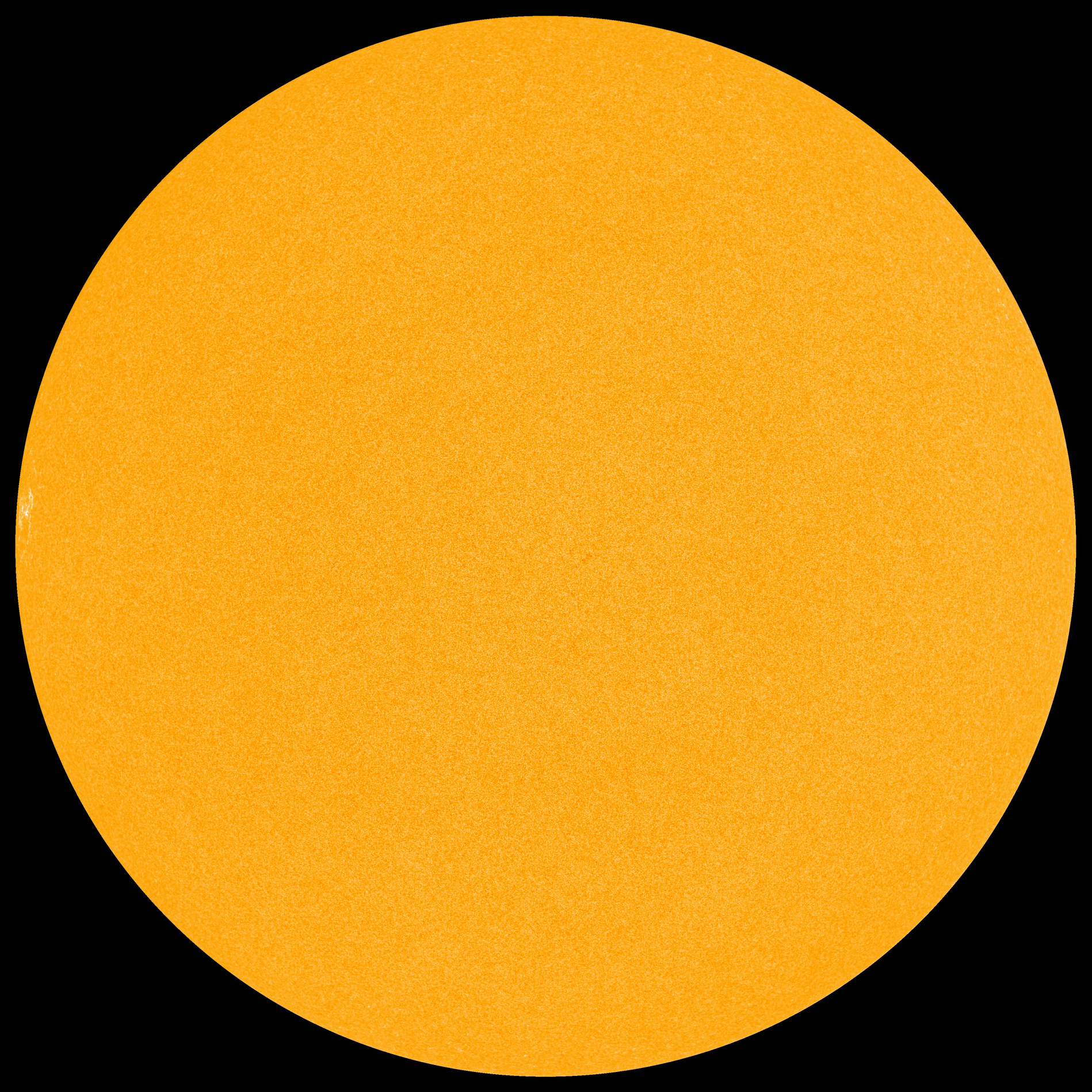

http://i.imgur.com/LyPuMma.png <-- ~2MB, full res solar image.
Any comments?  Is that well focused granulation, or just camera noise?
Spent some time today working on focus.  That image is the result of the use of a Schiener Mask, with focus iterated by reviewing high-ISO images on the LCD, then removing the mask for the final images.
  • Canon 70D
  • Rokinon 800mm, f/8 mirror lens
  • ISO 400
  • 1/1600s
  • Thousand Oaks SolarLite ND5 filter
  • Postprocessing:  Colour desaturated, contrast boosted slightly.
grnbrg.

Looks like granulation. Unfortunately, there isn't a spot on the sun right now: http://www.spaceweat...ianph8pg2m50lu2
Jerry
