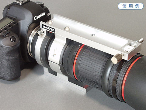

Wow, good to see all of the good info in there! The starter motor that comes with the starter kit seems indeed to be not so great, but I think it will suffice for my needs. If not, well I'll follow Tim's suggestions!
I'm still thinking about how to connect the motor and lens. I already have a microfocuser as depicted here (my guide lens and camera also sit on top of that microfocuser), and plan to put the motor on that microfocusing plate. I may just opt to have the motor rotate the screw of the microfocuser, or have a belt drive, or direct gear drive. I'll just need to make sure of the amount of backlash and dial that in.
