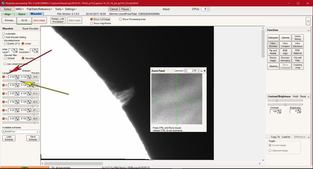

James, Martin, and Rick,
While it would be tempting to stack more, thereby averaging lower quality frames which in turn would require more sharpening (which in turn results to more noise),  logic dictates that these problems in stacking and deconvolution be tackled separately and efficiently. Let's try to get the best stacked  quality, first, and then worry about sharpening noise later.    That said, I do not have nor do I claim to have the magic bullet for either. I can only offer my process with the so so results above.
On stacking :
Generally,  imaging in  higher magnifications would be more affected by poor seeing and undulations. I suspect the above value of 7% stacked images may not work for you since you guys have wider FOVs than I. 20-30%  (or more) would be good for that 1000 EFL (500mm x2 barlow compared to my 505mm X4.3 telecentric barlow of the Quark + very small chip of ASI120).  Occasionally, AutoStakkert would produce unsightly stacking artifacts which would not be present if you used Registax, so try both.
On deconvolution: (The  wavelet values below presumes a 3X drizzle in AutosStakkert and 2X drizzle in Registax6)
If the values prove too much, move the slider (yellow arrow) accordingly. If the slider is at  minimum, but still too coarse, you can turn off the layer by ticking its box (Red arrow). Repeat process on next layer below. Again, this is my wavelet recipe for my setup so you must make adjustments for your own gear. Mottling noise, which would show up in the zoom panel, should not have hard edges. Otherwise, dial back your wavelets
I've used both IMPPG and Registax6. The jury is still out on these two, but I find Registax' wavelet to be superior. However, for my image #1 above, I used PS cc's USM with a value of 400 and a radius of 8. No further sharpening or noise reduction applied. I find PS's USM the best of the lot but I do use the other two when USM isn't as effective.
BTW: all the above are what I use for Proms only. Surface exposures require different values in aggresiveness.
if you wish, you could email me a stacked TIF. maybe, together we can find a nice balance of detail sharpness and noise smile.gif
YMMV
cheers,
