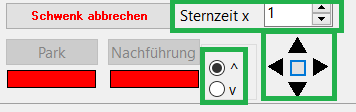

Hello Mr. Chevalley,
I recently updated to Version 4.2 and yesterday was the first night that I could use CdC together with ASCOM to controll my telescope (EQMOD). I noticed that the ASCOM dialog has changed a bit. Can you help me with some details?
See my Screenshot:
  • What does Sternzeit x ? mean - "Sternzeit" (german) means "Sidereal time"? When I connect to EQMOD, the 1 automatically switches to "4".
  • The arrow buttons indicate some kind of movement control, but actually nothing happens when I push a button, the checkbox in the middle cannot be checked.
  • The ^ V is the radio button for switching between N-S S-N movement... so far that is clear. Although I wonder if this overwrites any other setting e.g. DEC Reverse setting in the EQMOD Dialog?
Thank you for your help and for programming this great software.
Stephan

Hi Stephan,
This is all about a small virtual handpad to move the telescope in different direction at  different speed.
In English the text is only "Sidereal x" and is about the telescope speed in multiplier of the sidereal rate.  When you connect it change for the speed currently selected  in the telescope, 4x in your case.
The ^v selection is to revert the declination movement. This is common with german equatorial mount to revert the direction depending on the pier side. This not change anything in the driver, this only invert the up and down button on the right.
The four arrow are to move the telescope in the different direction. The middle button is to stop any movement in the case the mouse up event is not received by the program, this can occur when using remote desktop software.
But sure with 4x the sidereal rate it is difficult to see any movement. Change for a higher speed for testing, around 32x is good for centering in the eyepiece, 200 to 600 are to slew to another part of the sky. But the value range depend on your mount.
