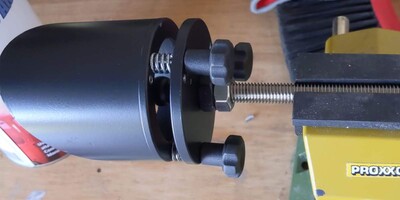

The cage of the secondary consists of two laser-cut metal circles and sports a gorgeous electric Moonlite focuser. The two circles of the cage are joined with golden metal bars, another aesthetic touch for the telescope. The secondary is held in place by four spider spokes with thin section, fully adjustable to setup the position and offset of the secondary, which however had been factory adjusted by Marco to perfection. I didn't have to touch them anymore. The structure is very light (it can be hold with one hand!) and very stiff. A single person can easily setup the truss tubes in place.
The structure is perforated to increase lightness while maintaining rigidity. One thing I didn't like about the Hubble Optics is the position of the secondary, outside the cage, which exposes the secondary to moisture and requires the use of a very long dew shield. The secondary in the DocTelescope, on the other hand, is placed downwards and remains inside and protected.
The secondary, as well as the cage of the primary, has ball connections for quick coupling. Simply insert the truss ball and turn a lever and the structure becomes very rigid. The secondary's cage is also very thin, so it transports well and can be handled with one hand. Marco provided me with a beautiful wooden box to hold the secondary, where I can also put the light shield cover and the rubber dew shield. On the cage of the secondary there is a handy attachment base for the finder. I would have liked to have two attachments, so I could also put a red dot, but I solved it by adding a second base on the side of the finder support. The structure of the secondary also serves easily as a base to support the rubber dew shield (which I made out of a decathlon Yoga mats), which I keep in place using camping straps.
Secondary cage details with attachment for finder
SECONDARY
The secondary is TS Optics, a German company that makes good optics. Marco has glued it perfectly to the structure of the cage, leaving also the necessary space for air passage and acclimatization. At my request, Marco also added springs to make collimation easier. I reserve the right to check the flatness of the secondary with a specific test.
Secondary collimation screws
Secondary cage
Secondary cage and wooden box

The collimation of the primary occurs through the use of two screws that press on the floating cell, changing the orientation of the primary.
The collimation of the secondary is done with 3 screws equipped with return springs, very fluid but rigid at the same time.
Once collimated, the telescope maintains the collimation all night long, even after pointing it in distinct areas of the sky very distant from each other and at the zenith.
