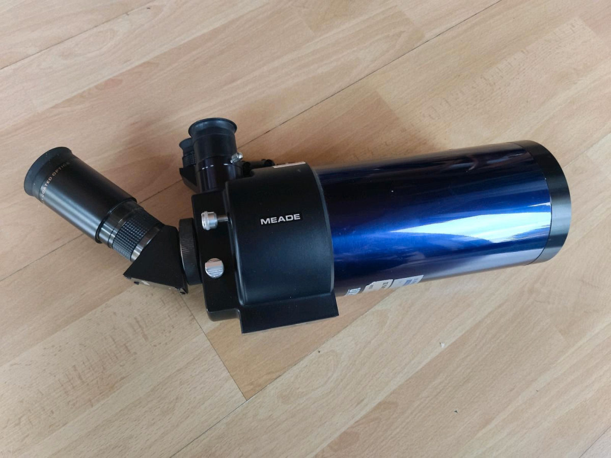

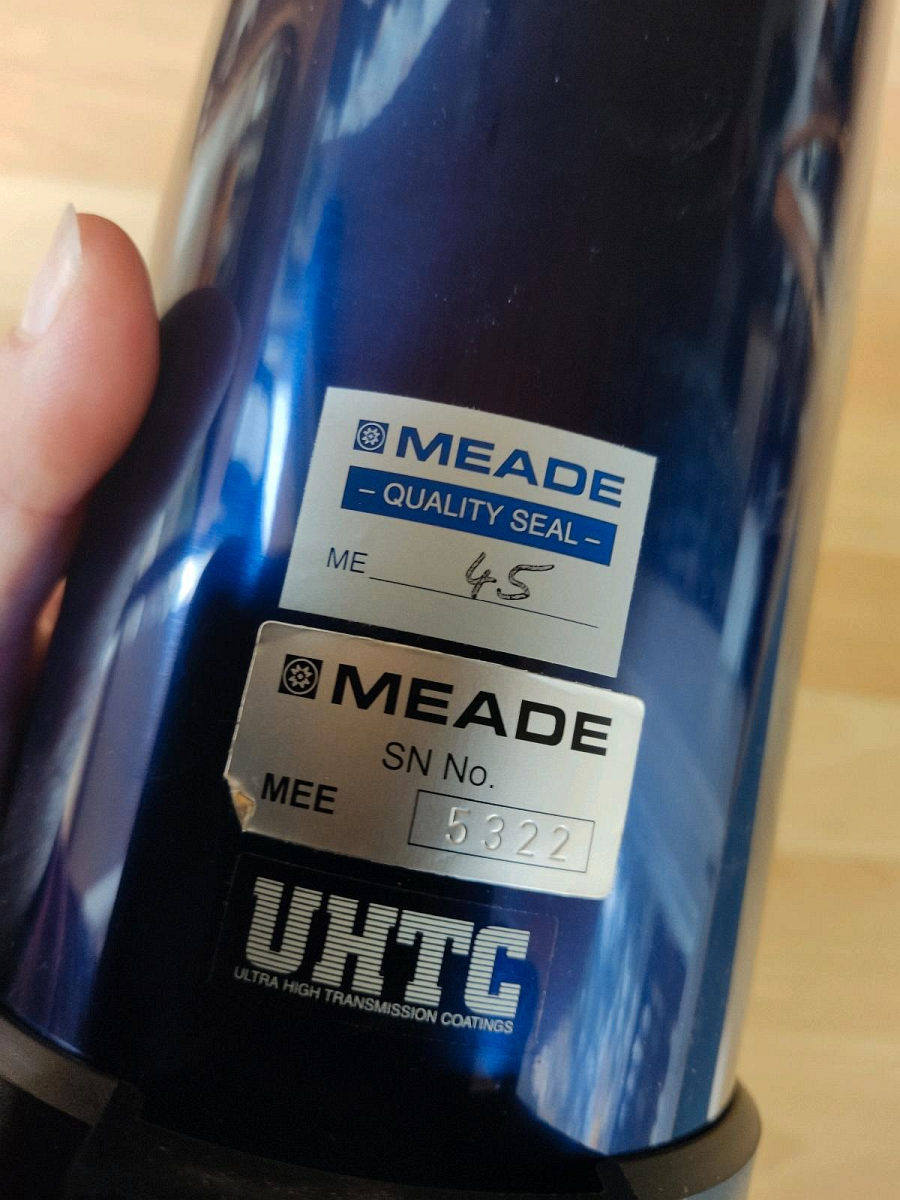

#60 LukaszLu
LukaszLu
  • Posts: 1,759
  • Joined: 28 Sep 2020
  • Loc: Poland
Posted 20 November 2023 - 09:36 AM
Hi, let me revive this thread to ask about an example I came across recently. It does not contain holes for the screws that attach the tube to the fork. Is this a model that was mounted differently or sold as OTA, without fork mount? How do you estimate the age of this example? There is a UHTC sticker on the tube, so at least 2002?
Edited by LukaszLu, 20 November 2023 - 01:09 PM.

#61 oldmanastro
oldmanastro
  • Posts: 1,722
  • Joined: 17 Nov 2013
  • Loc: San Juan, Puerto Rico-US
Posted 20 November 2023 - 03:46 PM
I may be mistaken but it seems to be from the earlier 2000s when the UHTC coatings were being offered. You may have something unique. I have never seen them offered as an OTA. You will find the optics to be excellent.
Edited by oldmanastro, 20 November 2023 - 10:54 PM.

#63 deSitter
deSitter
    Still in Old School
  • Posts: 21,407
  • Joined: 09 Dec 2004
Posted 20 November 2023 - 04:31 PM
There was an ETX spotter version.
-drl
  • ericb760, LU1AR and LukaszLu like this
#64 LukaszLu
LukaszLu
  • Posts: 1,759
  • Loc: Poland
Posted 20 November 2023 - 04:53 PM
Bull's-eye! :-)
https://www.opticspl...de-etx90ss.html
http://www.discovery...ext_90-125.html
  • oldmanastro and DouglasPaul like this
#65 ericb760
ericb760
  • Posts: 1,042
  • Joined: 17 Apr 2009
  • Loc: Palm Springs, CA
Posted 20 November 2023 - 10:41 PM
May I suggest that you consider a Wegat back plate for your new ETX-90? Since it was never on a fork mount but still has the flip mirror apparatus if it was mine I would definitely consider this upgrade. In fact, I have plans to de-fork my ETX-125 and add one of these.
  • LukaszLu likes this

#67 deSitter
deSitter
    Still in Old School
  • Posts: 21,407
Posted 21 November 2023 - 07:22 AM
Thank you very much. I'm not sure what condition this telescope is in - neither in terms of optics nor mechanics. If it turns out to be a keeper, I will consider various forms of upgrade, perhaps also the issue of the finder etc.
If you remove the visual back you will see that there are 3 collimation screws. This may convince you to "improve" the scope, but - leave it alone. They are set in the factory with fancy equipment and cannot be improved with tinkering. On mine the collimation screws have thread lock visible.
Not sure what that expensive visual back it designed to do, but you don't need it. The thread on the stock item is non-standard but you can get an adapter to convert it to a standard T-thread. I do this and then install a 1.25" visual back.
-drl
