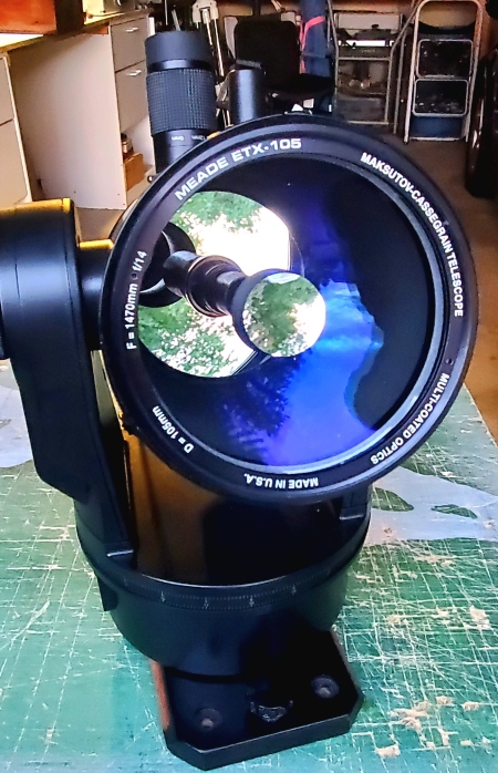

#217 MarkMittlesteadt
MarkMittlesteadt
  • Posts: 6,702
  • Joined: 08 Oct 2013
  • Loc: Weston, WI. USA
Posted 20 August 2024 - 09:41 AM
I've owned  multiple examples of every size ETX there is. Optically they are hard to beat. It's the mechanicals of both the mount and the back housing. One can remove it from the mount and replace the back with an aluminum Wegat plate.
My all-time favorite was an optically perfect ETX105 that a friend I sold it to brought with him recently for me to clean up. I regret ever selling it. 25+ years later and it's still perfect despite the flaws in it's mount, which still works.
You can see the replacement focus knob extension in this pic. It allows you to focus even when pointed at zenith...
You can also replace the useless stock straight through finder for a 6X30 RACI.
Edited by MarkMittlesteadt, 20 August 2024 - 09:42 AM.
  • deSitter, ETXer, Terra Nova and 5 others like this

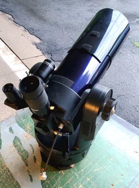

#218 MarkMittlesteadt
MarkMittlesteadt
  • Posts: 6,702
Posted 20 August 2024 - 04:50 PM
I'm all finished up cleaning and testing my old ETX for a friend I sold it to.
Here's a couple of better pics of it in the sun, if that helps you with modding your 90...
  • justfred, Terra Nova, Bomber Bob and 2 others like this
It’s nice to note that the Wegat plates are still available. If I were to buy another scope, (which I'm not), it would be a deforked ETX 125 with a Wegat back. It would be like having a poor (wo)man’s 5” Questar field model, (that is sadly never going to happen now that Questar seems to have scrapped plans for the Q5).
Edited by Terra Nova, 01 October 2024 - 02:44 PM.

De-forking my 125 and adding a Wegat Back breathed new life in to this aging OTA. I was able to fit a pair of rings on it using two strips of thick felt I bought from Scope Stuff. It may not be pretty, but it works perfectly. Now I can throw it on my AVX for goto capabilities, or throw it on a manual Alt/Az mount for a quick grab-n-go scope.
Rings
  • Terra Nova, Bomber Bob and Rick-T137 like this
