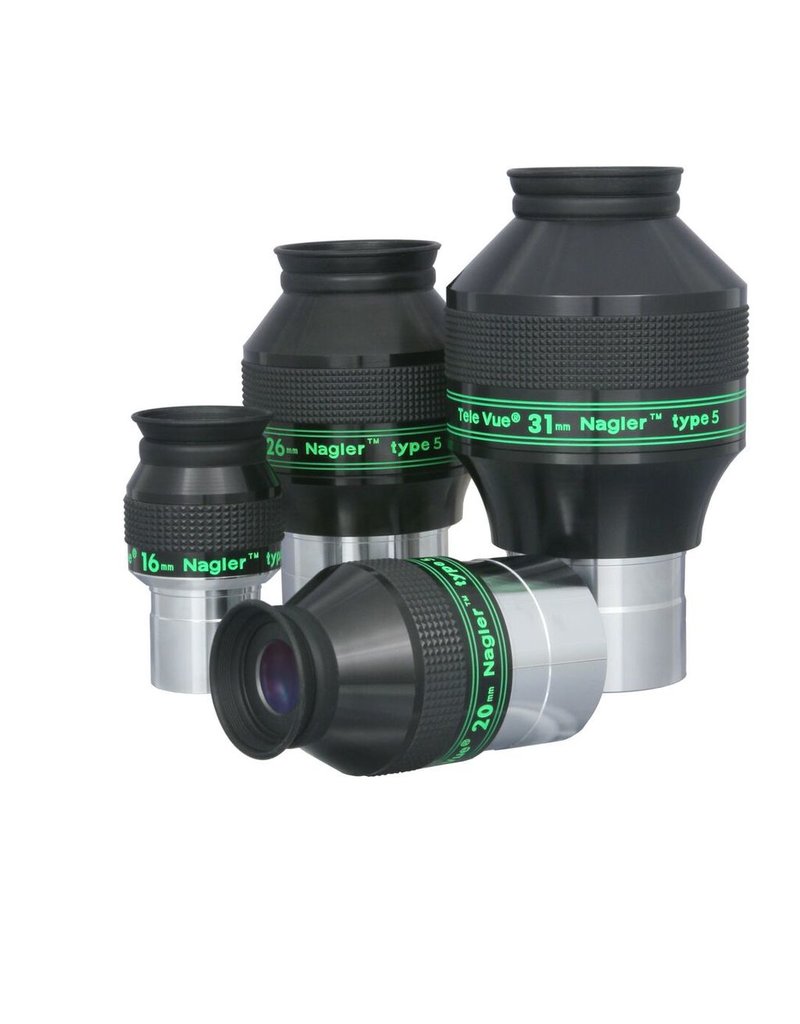

If you want to see a pure scaled design, here's the type 5 Nagler:
tele-vue-tele-vue-nagler-series-type-5.j
These do indeed get bigger and wider with increasing focal length.
You could make a 8mm T5 that was twice as short and twice as narrow as that 16T5, but it would have an eye relief of 5mm, and no one would find that comfortable for a 82° AFOV eyepiece (God knows how many people complain about the eye relief of the 16T5, even though I love it).

Just to add to Sixela's wonderful post:
The Smyth lens in the Type 5 Naglers doesn't have much of a Barlow effect. I have taken the barrel off both the 16mm and the 31mm Naglers and measured the field stop diameter.  The field stops are only a few percent larger than the published spec for the effective field stop diameter.
Since the field stop lies at the focal plane of the rear section of the eyepiece, after the Symth lens but before the magnifying section, this means there is very little magnification in the Smyth section.  It is there to correct aberrations.
Ernest distinguished between these two types of designs but I can't quite remember the acronyms he used.  I think one was FLFFF or something Field Lens Far From Focus.  That would be the short focal length eyepieces with a barlow like negative group in the barrel.
