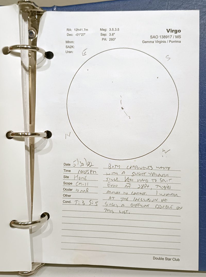

It's a bit closer now.
STF 1670 / Porrima
12h41m -01*27'
3.48/3.53 sep 3.05" pa 356.2*
It's interesting to me that it was difficult at 280x. A separation of 3.6" for such evenly matched stars doesn't sound that challenging at this point. They might be difficult for a BT because they are so bright, but I wouldn't expect to have trouble resolving it with the Orion CC8 Cassegrain at 170x, even at the closer 3" separation. Will have to give that a try now. wink.gif
And look how much the PA has changed in 21 years too. I guess the orbital period is 168.68 years, which is really short for a visual double star. It's only 38 light years distant.
Edited by Fiske, 30 April 2023 - 10:00 PM.

Thanks for the picture, Fiske.
You were facing SE, correct?  There are a couple of other stars shown, I think, when you make a drawing like that do you also review the fov area in an atlas and, so to speak, use that as a guide and prove to yourself seeing the other stars?  Also, what are those squiggly lines you drew there?
In the other recent thread about defining bino doubles, one poster referred to PA as it changes over time, just as you mentioned in this instance.  Now I would like to know a bit more about that, in this sense, it would be nice to be able to observe such a change, but I think his point was it can involve many years before it would be observable with amateur equipment.  I can understand that but wonder if binos generally don't prove high enough magnification or technique to make finer measurements in that effect.  Do I understand that correctly?

Hi, Clastro.
What direction I was facing doesn't matter because the telescope view is mirror-reversed (and probably upside down too). lol.gif The mount is a CI-700, so one establishes cardinal directions by temporarily turning off tracking to establish west (stars drift west). Then turning tracking back on and using the hand controller to move the field north to establish north.
The squiggly lines are the cardinal directions. grin.gif  E (top left) S (top right) N (bottom left) W (bottom right). That field star at the top right (south) is HD 110381 (8.88 mag). The other two stars have impossibly long gaia numbers. Their magnitudes are 11.64 (top right) and 12.44 (closest to Porrima).
This is a small field of view. I haven't done the math on it, but 0.25 degrees or smaller is my guess.
A list of doubles where orbital change can be detected visually is going to be small, and following those is going to be more a game for telescopes than for binoculars (because the separations are going to be quite small and the need for precisely establishing cardinal directions is considerable). wink.gif
So, no, binoculars are not ideal for observing double star orbits. If one were determined to pursue it with a binocular, the instrument of choice would be a binocular telescope at "higher" magnification. Say 80x. Or if one were a BT hero (like Jordan smile.gif) then 100x plus.

Thanks, Fiske, just to be sure I understand, the squiggly lines inside the circle are the path westward in the fov you observed looking at the target after turning off the tracking, correct?  And that path once it gets to the perimeter of the circle would designate the W point on the circle.  Then the other cardinal directions would be entered on the circle going counterclockwise.
