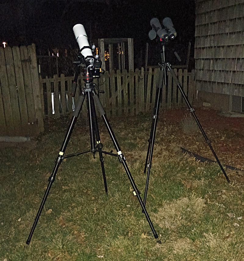

The Orion 100 definitely looks like it should be a great adventure in double stars.  I hope to get to it someday, and also the Cygni 100.  I may wait for the book to come out on the latter - hoping to get an autographed copy grin.gif.
My current double star journey is taking me a different way right now, and its a pedantic one.  But I recently finished observing the final two double stars in Orion that are on my list.  These were tough for me and required multiple instruments and eyepieces to confirm and compare views.  Both of these are multiple star systems.  They both have high contrasts in magnitude, where the glow of a bright primary overwhelms a dimmer, close-by 2nd or 3rd.  And as far as I can tell, neither of these is on the Orion 100 list.
Anyway, if you were to look at the constellation Orion, with head up and sword down, the two double stars that I am talking about are close together and at the left end of the belt.  They are Zeta Orionis or Alnitak; and just below it, Sigma Orionis.  The instruments I used, over a few day period, were the Vixen BT126SS-A, the OB BT-127XL-SD, and a supporting refractor - the AstroTech 125 EDL.  Eyepieces included Pentax XW 10, 7 and 5mm; Nikon SW 7 and 5mm, and Baader Morpheus 4.5mm.
Zeta Orionis, Alnitak, STF 774 A, B, C
From my log - Very tight, and exacerbated by the brightness of Alnitak. Used several different eyepieces.  A moon and sky glow filter helped resolve the A & B components with a 5mm eyepiece.  Focal length of the instrument used is 625mm.  Still spikes from the primary were present, but underlying dark band separating it from the 2nd was visible.  The distant and dimmer HD 290812 appeared brighter than the actually lower magnitude C component due to the washout effect from bright Alnitak.  STF 774 A,B C.  Components A & B are physically related.  C is not.
I will add that I was initially disappointed with the Vixen views - the spikiness of the 1.9 magnitude primary being so harsh.  But with the SW 5mm eyepiece success was visible in terms of separating the 2nd (2.4") by a visible black band under all the starbursts.  On another night I got after Alnitak with the Oberwerk 127s thinking that the view would be better.  But I was surprised that it was very similar to the Vixens, just slightly less harsh, with the separation not being as pronounced.  The best view was with the telescope, on yet a third night.  At 195x Alnitak was easily separated by the AstroTech in concert with the 5mm XWs, and there was very little spikiness from the primary, just overlapping diffraction rings. Would have been nicer to see this in stereo though.
Sigma Orionis, STF 762 AB,C, D, E
Log - Multiple star system, four stars with Primary Sigma Orionis A, then 2, 3, 4 as C, D, E.  Seeing C was the challenge with its 9ish magnitude within the brightness of the 3.8 mag primary.  Located about 1 degree SE of Alnitak.
Component C was definitely the challenge for this system.  Very difficult to see and to hold with the Vixens - until I inserted the 4.5mm morphs.  This worked the trick with component C.  The contrast was such that, once popped, I could hold it indefinitely.  Subsequent views with the OB 127s were not quite as contrasty, with C still visible.  And the AT 125 delivered an equally hold-able view at 195x.  I must say that this multiple star system is beautiful and distinctive when included with HD 294272 A&B and HD 29471 in the same FOV.
It has been an interesting double star adventure in Orion with these instruments:
Edited by aznuge, 05 March 2024 - 03:32 PM.
Alnitak / STF 774 is 1.74/3.70 at 2.1" separation! shocked.gif That is deep APO refractor territory, my friend.
One thing I maintain about the Oberwerk 120 and 127XL is that they are outstanding instruments, but really better for low to moderate magnifications. The 100XL-SD is actually a better choice for higher magnification views because of how the design scales. wink.gif
BUT, don't I recall you owning a Takahashi 120?
That seems like the natural choice here...
  • aznuge and jrazz like this
lol.gif You may be right.  I've not been in a rush on this, but probably time to take it out of the hangar and let it take flight - at least to see if it has what it takes to be a support refractor on the team.  The AT125 EDL has already proven itself as "not too shabby".  Perhaps its time to see what the TSA 120 can do.  hmm.gif smile.gif
