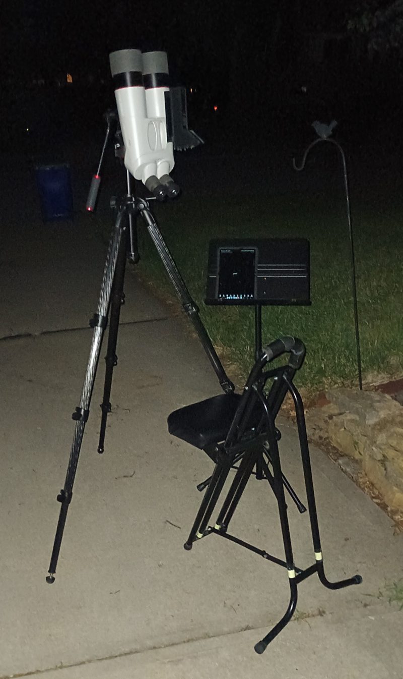

#583 Fiske
Fiske
    Oberwerk Ambassador
  • Vendor Affiliate
  • Posts: 9,830
  • Joined: 14 Mar 2004
Posted 24 June 2024 - 07:15 AM
Here is a trio of doubles from last night (Sunday 23 June 2024) observed with the 82XL BT with Pentax 14XW eyepieces (32x) and the Tak FC-100DC with the Televue 24mm Panoptic (31x) and 13mm Nagler Type 6 (57x).
STF 2351
18h36m +41*17'
7.60/7.64 sep 5.0" PA 160.4*
North of the Double Double in Lyra, and easily located. Evenly matched white stars, resolved by a hair at 32x. A splendid double in a lovely field. And a pleasing reminder that regardless of how many times one has visited a given region of the sky, there is still more to see. At 32x this is a subtle double star, close enough at 32x to easily pass by, but it comes into view with more careful study.
Jordan previously included this double star in an list for Lyra, so I believe she probably has observations of it with the 100XL, which would be a great choice for observing it.
STF 2021
16h13m +13*32'
7.43/7.48 sep 4.0" pa 0.4*
Named 49 Serpens, this double is actually in Hercules (near the border with Serpens) and easily located working from the bright trio of Beta, Kappa, and Gamma Serpens. Seen as evenly matched amber stars with the 100DC and as two stars in contact with the 82XL+14XWs, at the 32 resolution limit for me. Stelledoppie notes indicate that this is a high proper motion star that has drifted across the border from Serpens into Hercules. The excellent binocular double Marsic (STF 2010), which can be viewed with 20x binoculars, is just to the north.
STF 2007
16h06m +13*19m
6.89/7.98 sep 37.74" pa 322.4*
Just west of STF 2021, in a pleasing arc of three stars, I noticed this double while roaming the field with the 82XL. Warm white primary with a white secondary at a friendly distance. Primary brighter.
Edited by Fiske, 24 June 2024 - 07:26 AM.
