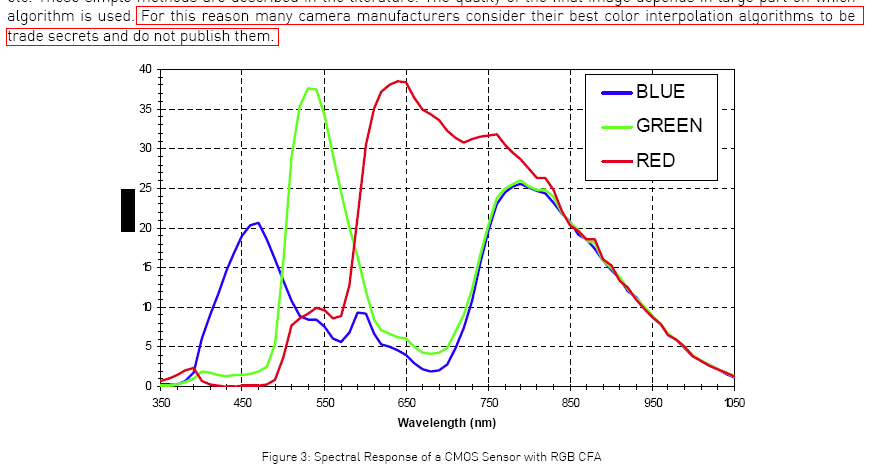

Your camera still has a Bayer matrix filter for color over the sensor.  That system has little response at wavelengths shorter than 350.
https://pic4.zhimg.c...b7cd5bce2_r.jpg
The filter will block the relevant IR.
https://nimax-img.de...d-Filter-2-.jpg
So, no.
Take home message.  Look at spectral response curves.  Google is a good source.
