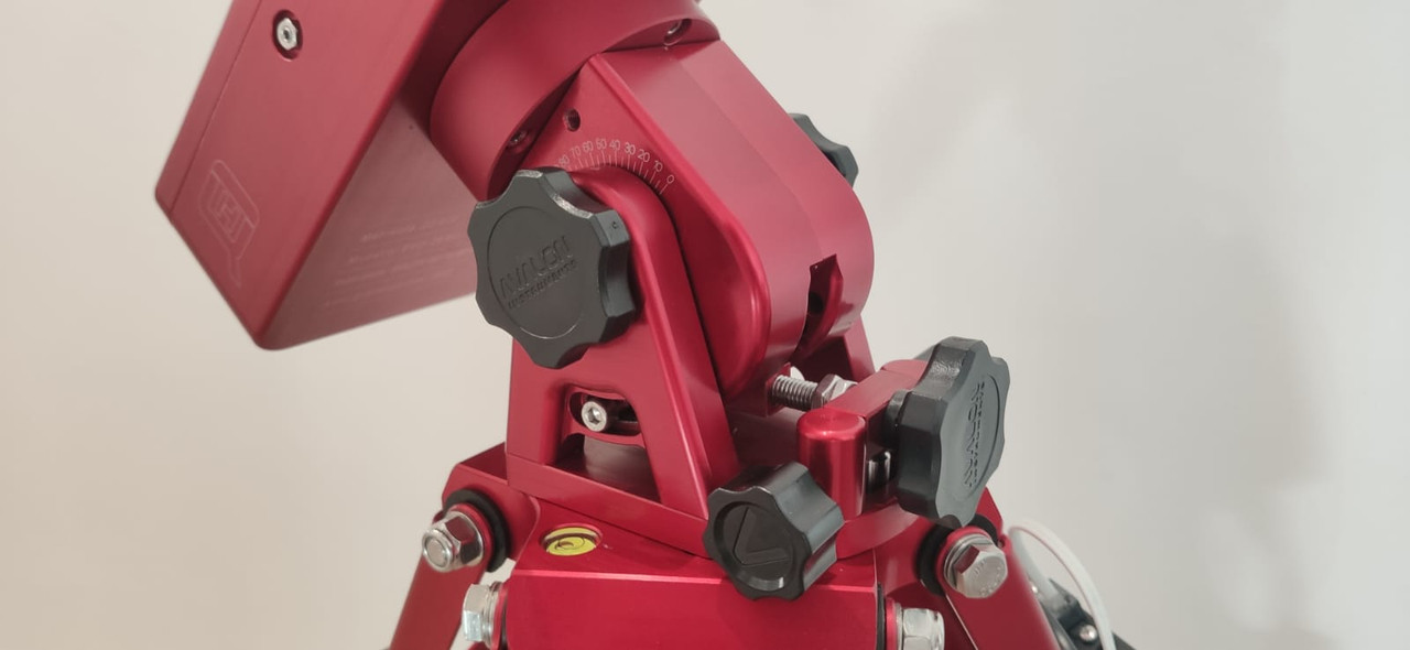

This is the assembled setup, ready for imaging: attached on the Evo Zero HQ there is the 420 mm Evostar72 Ed and the Asi Zwo 294MC camera, all remotely controlled by Astroberry Server.

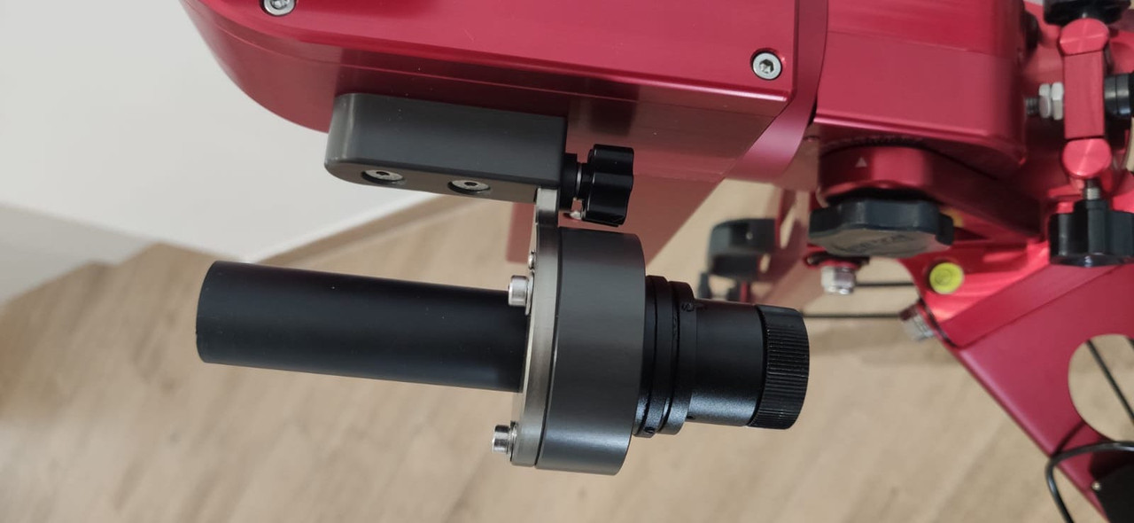

The first step is the polar alignment which is easy to reach thanks to the polar scope located on the left side in its dedicated bracket and the comfortable adjustment knobs for the Height and Azimuth.
Both allow a fluid and precise movement and the result is very accurate (in the image below the precision reached using Sharpcap's polar align tool)
