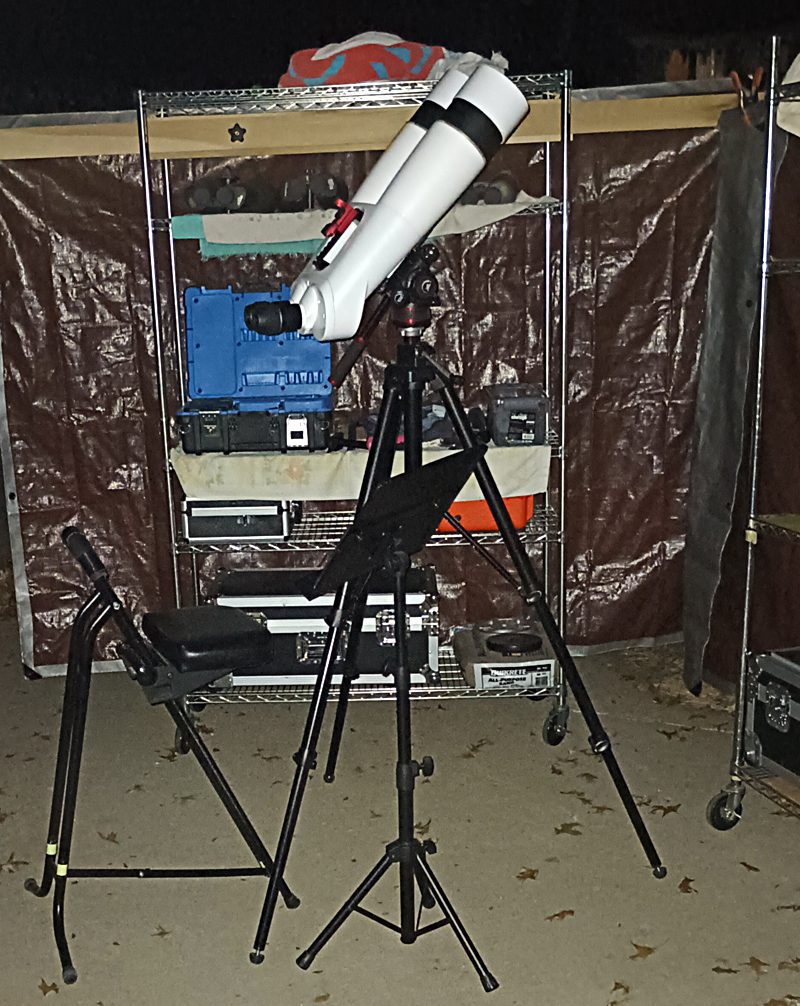

The Oberwerk 120XL on a Manfrotto 475B tripod with an NT612 head, and yes it works well. wink.gif
I'm with Rich on setting the drag high enough so the BT has to be deliberately moved.
I took this picture last night after glimpsing M 33 from my yard for the very first time. lol.gif Had thought about using the 127XL on the iOptron Tri-pier, but I opted for the 120XL setup because of the threat of early clouds (which unfortunately materialized). I was only just able to see a portion of the core in averted vision. But the viewing conditions were not ideal, there was a waxing crescent moon in the south west (33% illuminated), and Triangulum wasn't that high in the sky. So, I'll be trying this again on a better night, later in the evening.
