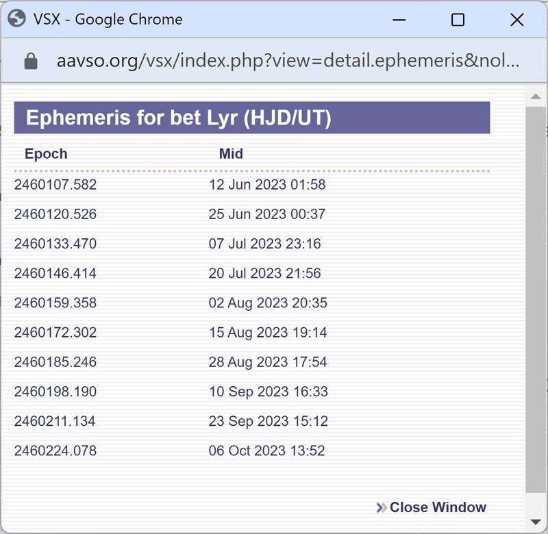

Last night, about 10 pm PDT, Sheliak matched the magnitude of Zeta1 Lyrae. It was definitely fainter than Sulafat. Observed through my BT100 at 25x. This variable star observation is fun and easy to do. Thanks Fiske!

Here is a screenshot of the AAVSO Ephemeris for Beta Lyrae. If I'm understanding this correctly, the minimum should be at the Mid date -- which is the mid-eclipse. So Sheliak would have been at its faintest on July 7. (I think the time given is Universal time.) The next time it will be at minimum would be July 20.
