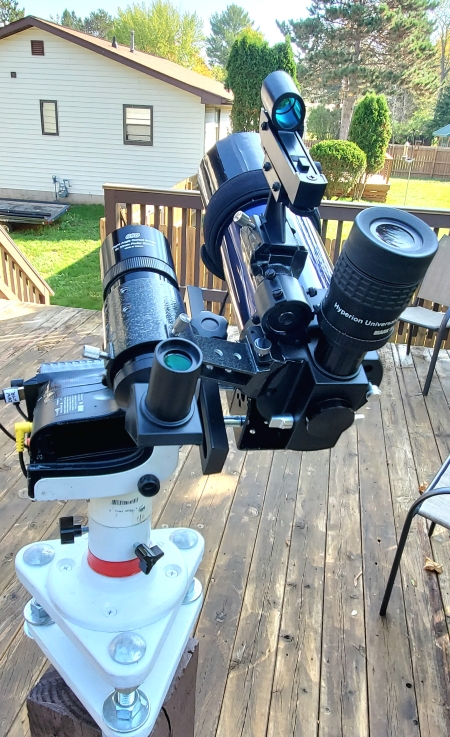

I've been around a few GoTo scopes, and they always take longer to get up and running. Sometimes they don't work right either.  I've always enjoyed the tracking aspect of these scopes though. I don't mind manual tracking, but it's pretty sweet to walk away from the scope and return to the same fov, especially since I really like 68-70 degree long eye relief eyepieces.
Tomorrow I will get my first EQ mount since the Powerseeker 127 EQ I entered this brilliant hobby with. I found a Tom Osypowski EQ platform 20 minutes away, and it's a really good price.
I hope this platform will allow me to have those nice tracking views when I want without compromising the zero electronics nature of my scopes. When I want tracking for high powers, it's there as an option, but I can also leave it at home.
We'll see how it goes, but I'm excited to add this capability to my scopes.
