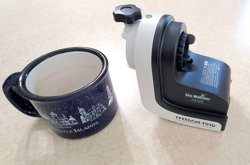

This is what I love about my AZGTi. I don't have to do anything with it, except get it reasonably level. I don't even have to polar align it (though I typically do a quick "eyeball it", rough alignment). I turn it on, manually slew my scope to an object I want to view, and tell my mount to track it, especially if it's like a planet at high power with my 90mm Mak.
It would easily handle a C5. It handled my deforked ETX125 with a Wegat back, rings and accessories that weighed in at 12.4 lbs. I'm actually thinking about getting a C5. I've owned a C6 and the C5 looks just about right for me.
Otherwise, if I'm just out with my AT72EDII and a 40mm WA EP star gazing, I don't even turn my mount on. Manual control, Point and Track, or full GoTo. It's a super small, lightweight do-it-all mount.
Now if I could just get it to brew a pot of coffee for me...
I also put the mount on a very lightweight surveyor's tripod, but I often put it on my deck pier.
If you get a good one, the az-gti is outstanding for the price. I love mine, and so far so good.
Bob

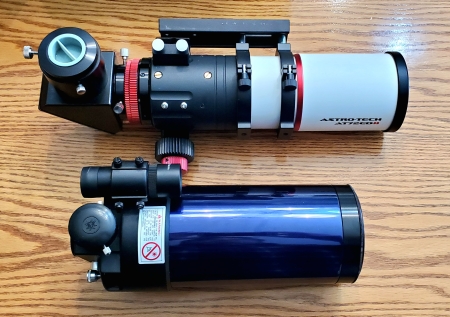

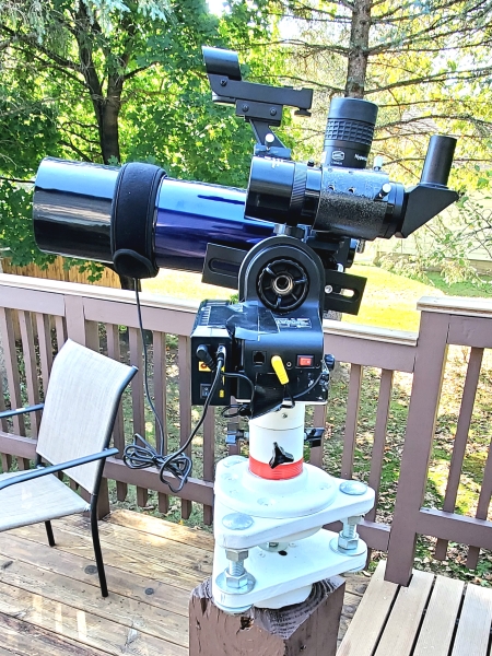

As far as portability, I own both an AT72EDII apo and it is really small and light, and also a deforked ETX90, a 90mm Mak. The AT72EDII at f6 (420mm fl) gives me nice wide field views with my 40mm WA EP, but the 90mm Mak (f13.8 (1250mm fl) gives me very sharp detail at much higher power. It's actually smaller than my AT72EDII.
  • Rayje1997 likes this
Nice, what do you find that 90mm Mak to be good at?
  • MarkMittlesteadt likes this
The Moon and Planets is all I use it for. Narrow FOV but takes much higher power than any good to great night of seeing could ever allow. At 1250mm focal length with my 2X Barlow and Baader 8-24mm zoom, I can get as high as 312X. The seeing is never that good, but the scope and EP can go that high.
The other night the seeing would allow for maybe 150X at rare moments. I could see only two distinct cloud bands on Jupiter, but also some subtle coloration differences on the planet. All four of the largest moons were easily seen and one was super tight to the edge of the planet and I watched its occultation with Jupiter. No small feat with Jupiter being so bright.
The craters and ridges along the Moon's terminator were stunningly crisp and detailed. Again despite the questionable seeing conditions.
Planets would be brighter and larger in a C5, but the 90mm is so small that it makes a great grab'n'go, that would even fit in a small camera backpack. It's only 12" long (with the diagonal internally built in). When I use it, I only go out with the 90mm Mak, my 2X Barlow and 8-24mm Zoom.
Putting it on my 6 lb. AZGTi and using a nice lightweight tripod makes for a very small and light grab'n'go set up. The scope, EP's, finders and mount combined only weighs a total of about 10 lbs. max. A small back pack could easily carry the ETX90, EP's, Finders and AZGTi mount, leaving only a small tripod to carry.
Edited by MarkMittlesteadt, 05 October 2023 - 10:38 AM.
  • Bob Campbell and Rayje1997 like this
