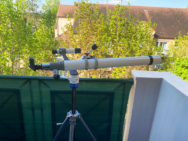

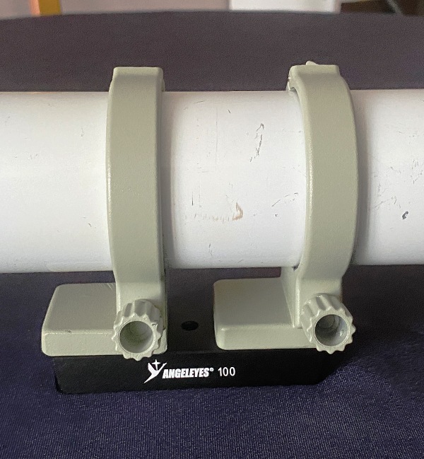

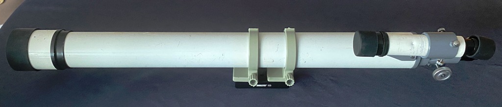

I used your solution to be able to mount the OTA of my vintage 60/800 refractor on an altazymutal mount
The system works very well, you just have to adapt the inner diameter of the rings with self-adhesive felt so that the OTA slides well without play
The result is very nice
Pascal
