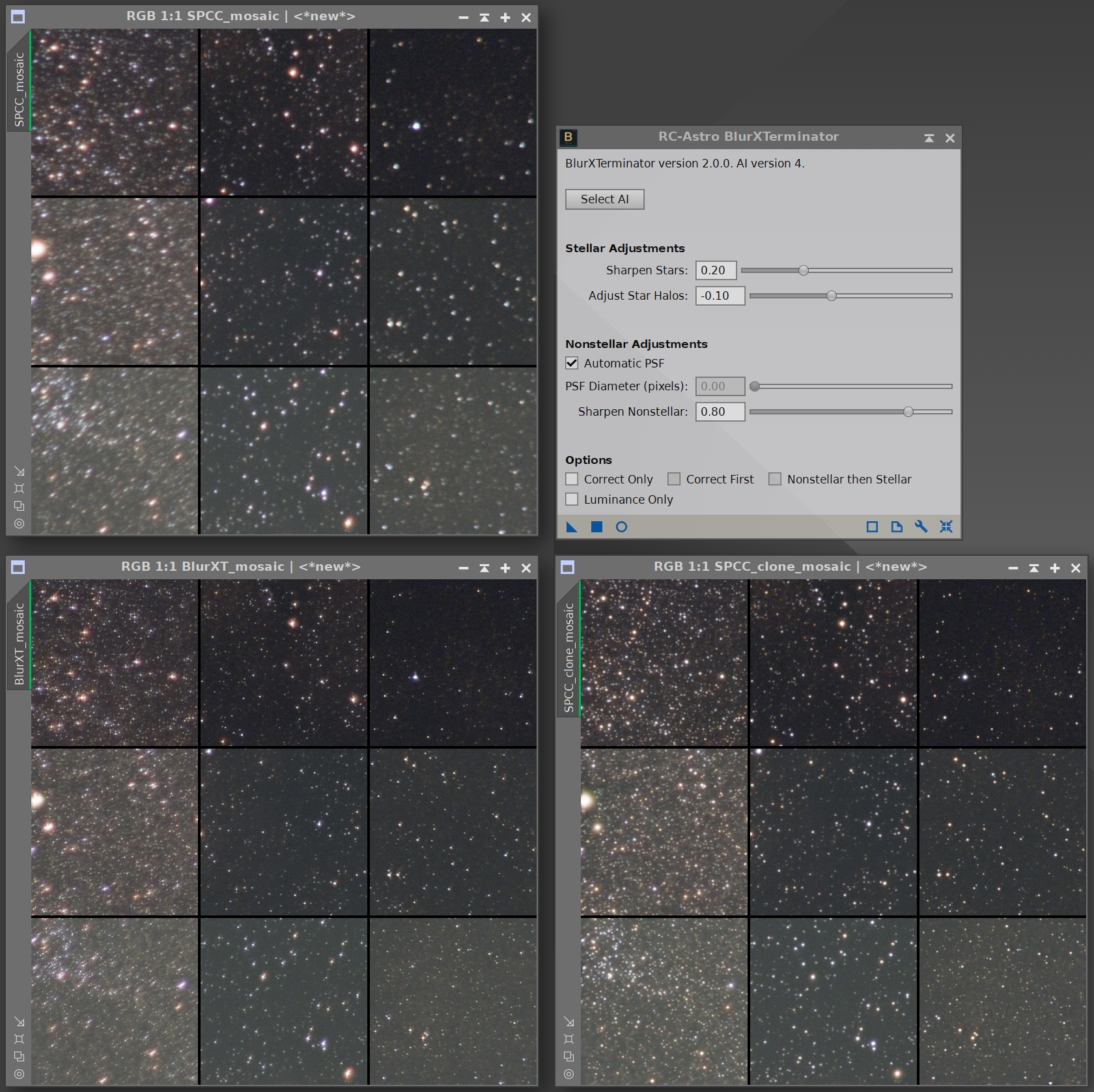

Here's the corner of an integrated image affected by off-axis astigmatism and coma, processed with AI2:
Here's the same corner, processed with AI4:
Image 1

And aberration correction is only one of the new features. Another one, very important as well, is the conservation of star flux! So you can correct stars first, and then do SPCC.
  • psandelle likes this

The improved optical aberration correction does work quite a bit better with my data.

It's a big improvement for sure! Especially, when it comes to elongated stars.  I had issues last year with tilt and mirror heat expansion that resulted in elongated stars in the bottom right corner of my images.
Here is an example starting with the original:
The Version of BXT with AI2 resulted in this image:
And, with AI4 this image:
Very impressed!

The big change is auto PSF actually now does something. Previously it did nothing! Manual PSF often gave better results.  Correct first may be mute? More testing needing really. Did anyone notice the the default star reduction is now 50 and stella sharping has been knocked back by 30%?
Who needs a field flattener right?

After weeks and weeks of dialing in my Celestron Edge 9.25 with reducer I was never able to get good stars even at APC size with a blue filter.  All other filters were great at full frame size on an ASi6200.  I adjusted back focus from 146 all the way to 152mm.
That has now changed!  My stars in the corner with an enlargement equivalent to a 6' by 3' in the blue channel are perfect.  And I mean perfect!
Amazing....

I disagree that dealing with bad stars on something like a Samyang at f/2 (try imaging at f/1.4!) is something you overcome with skill.  Fast lenses usually are nearly unusable for astrophotography and the only way to "fix" them is by infinitely returning your copy until you get one that happens to be well corrected across a field.  There's no skill in that.  Even extensive adjustment of backfocus (which wastes clear nights) often does little, if anything.  I see this new version of BXT as only a good thing.  It'll let people make use of their fast lenses without having to spend a lifetime adjusting backfocus or having to buy 10 copies of a lens in the hopes of getting a good one.
Plus, even the new version is far from magical.  While the effect on coma is vastly improved, there is still visible tilt in my pictures taken at f/1.4.  It's mild enough to be usable, but I will still try to fix it through tilt adjustment.

Some examples of the new BXT vs the old BXT:
Original image
Previous version of BXT
New version of BXT

Testing with data from the 200mm Canon F2.8 operating at full aperture. (surely not a good idea!).
Top : Original data
Bottom left : BlurXT V1 AI2
Bottom right : BlurXT V2 AI4
This a renaissance for fast optics maybe even classic old lenses from Film days (that are now cheap on Ebay!). Opening a less costly route for beginners to great images. I like it.

Initial testing indicates it’ll be a significant leap for me as I tear down my system after each use, so I never have super perfect tilt or collimation…. or anything.
Also with a full frame camera in my reduced observational Dobsonian, I’m pushing well past the design limits so my corner stars are never perfect.  I’ve managed to get them pretty decent, but always a bit oblong in one corner or the other.
Now they are pretty much round with BXT 2.0 corralling those pesky photons back to where they should be!
