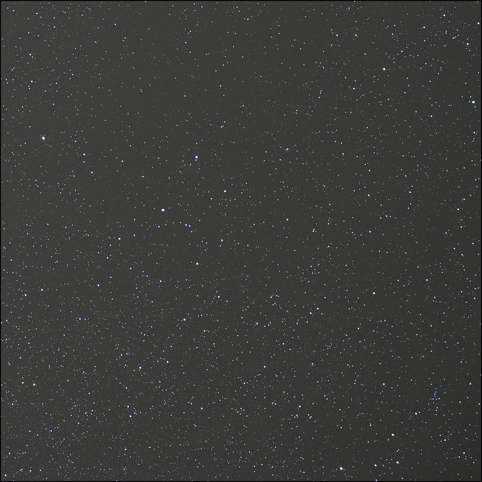

Very interesting article on the results of the new Nikkor 135mm f/1.8 Plena being used for Astrophotography. Nice corners.
http://Using the Nik.../#ixzz8PU1aDkQb
Author Dominique Dierick
https://flic.kr/p/2ps1YLe
  • ewave, Bill Schneider, brlasy1 and 2 others like this

The corners look decent but let's keep in mind this was taken with a Z6.  One of Nikon's 45MP cameras would be a better indicator of quality.
  • Kevin_A likes this

The purple fringing on the stars evident in the nebula image is indeed horrible.  However, I wouldn’t write the Plena off too fast, since there are clearly issues with this image.
First, the stars are hugely overexposed.  If the same conditions were used as for the flaming star nebula image (on the flickr album), each exposure was 2 minutes at f/1.8 and iso 800.
Second, there are very clear processing artefacts:  the bright stars show a dark ring around the blown out core, surrounded in turn by a purple fringe
Some other images, less obviously overexposed, are shown by the author in the article on Nikon Rumors and the stars there look very good:
https://nikonrumors....otography.aspx/
Andy
Star shape looks ok, all the images have a huge amount of chromatic aberration, definitely not worth the price tag for astro use given those results and the other options available.
Can you base it off a post processed image nowadays though?
Who knows if something like BlurXTerminator wasn't applied to it?? confused1.gif

I agree that the image posted looks to have a ton of fringing, but that wasn't my experience with the lens when I tested it out. I owned it for a couple of months and sold it only because I needed to sell either the 135 or 85mm 1.2 and decided to keep the 85mm. I use both primarily for daytime photography, but did do a quick test with the Plena and didn't see that kind of aberration. I wish I'd kept the files. I think this example may be a byproduct of processing rather than an indictment of the lens. I don't know that the Plena is worth the premium over the sigma or sony GM. In lab tests, the sony GM 135 is supposed to have color fringing, but that is maybe the best lens I've ever used for astro when stopped down to 2.2-2.5. So, I don't know that the Plena is worth 1k more, but the plena does have better rendering and bokeh for daylight use. I wish I'd used it more for astro to get a feel for it.

I see an almost perfect lens with very little to no distortion. I mean he shot it unguided, wide open at f/1.8 with no calibration frames and just a quick post process.
I might have to rent this lens and slap it on my Z6iia for further analysis.

Apart from some outliers, nikon tune their lenses to people. So stuff like what we are looking for, is low on the list for the designer.
Still, I noticed this from the corner of the plena, I assume wide open. Looks like focus was missed by a hair - easily done.
It definitely beats their 50 1.8S lens as he shows (below). The CA that seems apparent may be due to his over blueing of this area, which naturally isn't these colours. The stars look all mostly blue, which indicates some mangled colour IMO. This along with the slight focus miss I see here, I don't think we can judge it on CA just yet though...
That said -
Rok, and Sigma win, especially when price comes into it.
Exceptions - 14-24/2.8S at 14mm. If you want a 14mm lens for a star tracker, this one is incredibly good at f/2.8 for star shapes, even slightly better at f4. It's pretty good at 24mm too. 70-200/2.8S. I use this alot at 200mm and the star shapes around 3.5 are decent. I use it for daylight too, so it is a win win for me.
Sigma, and Voigtlander and to an extent Samyang, or Rokinon or whatever they name themselves in each country are where the game is at for this mostly though...Now to pick up that 50 APO lanther. Soon...
This image has really hit home how much better the APO is at f/2 - (this is the 50 1.8S at 2.2) -
See the full res downloadable plena shot here on flickr - some dark halos around the stars and slight focus miss make it hard to judge. If wide open as he states, this is pretty good star performance, given you could shoot this all day at 2.5 if good focus prevents CA. https://www.flickr.c.../in/dateposted/
