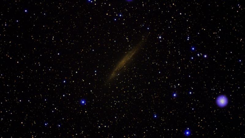

I had an idea for how to easily correct CA in achromatic refractors, making them suitable for full color imaging with one-shot color cameras. This idea, which I call the synthetic blue channel method, has now been implemented in SharpCap 4.1, as of yesterday's release. You will find it in the right hand pane under Preprocessing (same place as darks, flats, planet disk stabilization, background subtraction, etc). It is suitable for planetary, lunar, and deep sky imaging, even solar if you are doing that with a OSC camera and a white light solar filter.
I've made a video explaining how it works and demonstrating it on several images, both planetary and deep sky. I didn't include lunar examples in the video, but it works spectacularly there as well (maybe the best of all, really).
https://www.youtube....h?v=Hc7Tjcq5WIg
To get the best out of this method you MUST image through some sort of fringe killer/minus violet/violet reduction/#8 pale yellow/495 long pass type filter. The filter must also have an IR cut (like the 495 long pass) or be stacked with an IR cut filter (for example the #8 pale yellow would have to back stacked as it has no IR cut). This is to prevent defocused blue and IR light from polluting the red and green channels as well as the blue, which is critical to the method.
My hope is that this lowers the bar to entry into the astronomical imaging and EAA hobbies.
Thanks, and clear skies.

One interesting  potential use of this tool with (some) APOs that may exhibit blue fringing:
If you look at the spectral response of  OSC cameras (like the 2600MC shown above), you'll see that between 400-450nm, the B channel is the only channel with any noticeable sensitivity in that narrow spectral range - the R and G channels have less than 10% relative response from 400-450nm.
So if you have an APO that has a bit of blue fringing, it's likely that replacing the actual blue channel with a synthetic blue should remove the blue fringing. As a UV cut filter only cuts below about 400nm, it won't help with potential blue fringing from 400-450nm.

The question is whether or not replacing the blue channel with a synthetic one reveals a faint red fringe that had been masked by the blue. If that's the case, you'll still want to image through some sort of mild CA filter to get the most benefit. As I mentioned above, this is definitely the case with my AT70ED.

Bravo Borodog! I've implemented the basic idea in Jocular for mono + filters, and can flip between RGB and RGsynB to quickly see any differences.
Since these are not live captures I've linked to my gallery.
First impressions are that it maintains (NGC 2169) and in some cases improves (NGC 2017) star colours, so it is certainly a potential time-saver for those of us doing mono + filters. B is generally a bit of a pain too as sometimes it can be hard to find enough stars to align on, so doing without B will help there too.
It was particularly fun to see Sigma Orionis, one of the bluest clusters.
The only place so far that I'm seeing a big difference is in bright nebulosity like M42 or M8, and bright planetaries eg M27. In both cases the purply-reds become golden-oranges (rather nice actually). These cases would perhaps benefit from a different weighting of R and G in creating the B. [in edit] I've just read far enough into your thread in the deep sky imaging forum where you get something similar; I'll try your suggested formula.
I should say that these are with a Newt, so no CA to correct.
Edited by MartinMeredith, 31 January 2024 - 07:59 AM.
Yes, it is certainly possible that a red fringe would be revealed, particularly with a doublet like the 70ED. However, I think it's still worth trying the synthetic replacement for scopes with better colour correction than the 70ED, but which still have a little blue fringing, to see if there is any resulting residual red fringing.

Did you watch the video I linked? The method to use with bright Ha emission nebulae is not 2G-R, its G + (G-R), where the second term (G-R) black clips when R > G.

Mike, congratulations on an outstanding idea. And of course, a big thank you to Dr Glover for the implementation.
The results are astonishing.
Some background. Last year I experimented with my Vixen NA140SS to see if it was suitable for EAA - a 140mm refractor with a flat field at f3.9 (with reducer) sounds attractive. The NA140 has a second pair of correcting lens, (similar in design to the Petzval design) that creates a flat field and significantly controls CA. The results were not good enough and I put the idea on hold and kept the scope as my main observing refractor.
I have put some images through the Test Camera tool and applied the CA reduction tool. All I can say is wow !!!!!.
All of the original images displaying CA were taken in April 2023. Seeing conditions hovered between 5 and 6 FWHM. My observatory is under Bortle 4 skies.

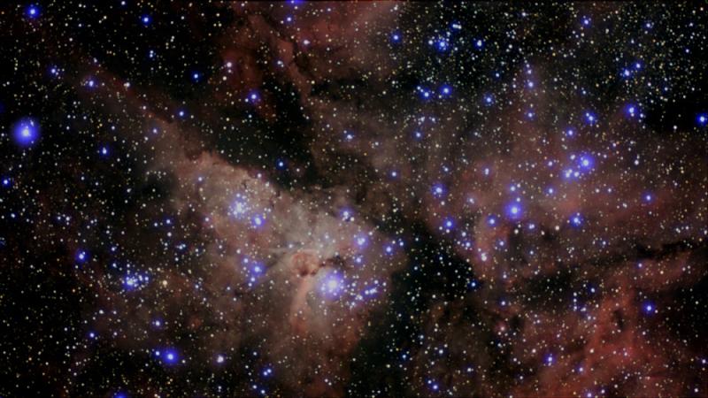

My first comparison is for the Carina Nebula. Note, the originals were recorded without any filters, other than an IR cut filter.
NGC 3372_2023-04-25_NA140SS_ASI585_SC_40X15.0s_600s_Gain252
With Deep Sky 1 Ca Reduction: I have not made any adjustments.
NGC 3372_2023-04-25_NA140SS_ASI585_SC_40X15.0s_600s_Gain252_DeepSk1 CA Reduction.jpg
I will post some further comparisons shortly.

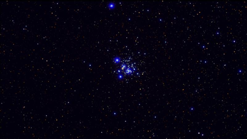

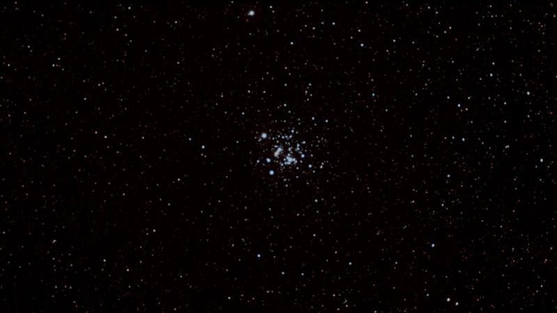

Jewel Box Cluster_NGC 4755_2023-04-25_NA140SS_ASI585_SC_65X4.0s_260s_Gain252. Original with no filters, other than IR cut.
Revised image with Solar System CA Reduction. No other processing.
NGC 4755_2023-04-25_NA140SS_ASI585_SC_65X4.0s_260s_Gain252_Solar System CA reduction.jpg
  • steveincolo and dcweaver like this

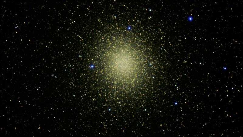

Comparisons continued from previous post:
Omega Centauri_NGC 5139_2023-04-25_NA140SS_AS585_SC_75X4.0s_300s_Gain400. No filters, other than IR cut.
NGC 5139_2023-04-25_NA140SS_AS585_SC_75X4.0s_300s_Gain400_Solar System CA Reduction.jpg

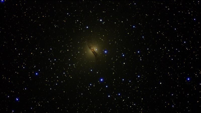

Hamburger Galaxy_NGC 5128_2023-04-25_NA140SS_ASI585_SC_38X8.0s_304s_Gain400
NGC 5128_2023-04-25_NA140SS_ASI585_SC_38X8.0s_304s_Gain400_Solar System CA reduction.jpg
Edited by Far_Southern_Skies, 01 February 2024 - 04:50 AM.
  • steveincolo, dcweaver and ziggeman like this

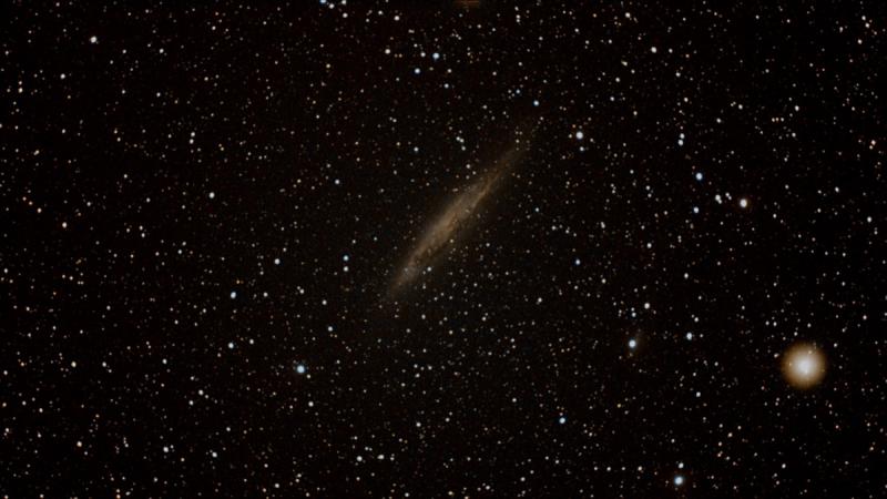

NGC 4945_2023-04-25_NA140SS_ASI585_SC_38X8.0s_304s_Gain400
NGC 4945_2023-04-25_NA140SS_ASI585_SC_38X8.0s_304s_Gain400_Solar System CA reduction.jpg
  • steveincolo, PeterAB, dcweaver and 1 other like this
