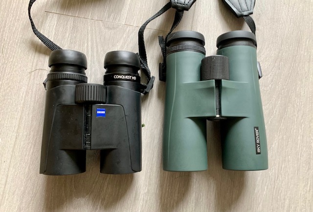

#1057 astroneil
astroneil
  • Posts: 2,536
  • Joined: 28 Jul 2009
Posted 04 August 2024 - 02:43 PM
Helloha,
I’ve been comparing the SRBC 8 x 42 to the Zeiss Conquest HD 8 x 32 over a couple of days.
Will have that mini review for you all a bit later on…..
Neil.

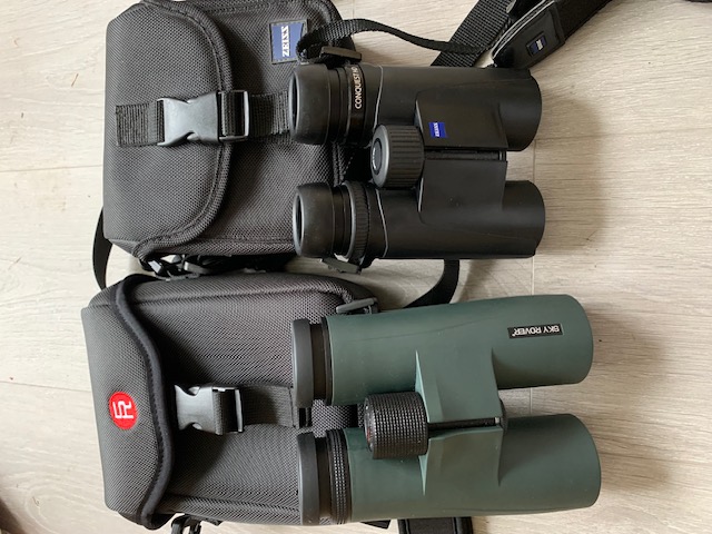

#1069 astroneil
astroneil
  • Posts: 2,536
Posted 04 August 2024 - 05:29 PM
Ok here we go:
Some background: the Zeiss Conquest HD series is widely regarded as upper mid-level in terms of optical performance and in general rates among the best of the $1K priced binoculars on the market IIRC.
The following observations were made only during bright daylight, either in bright sunshine or bright overcast skies. But I also tested for artefacts by shining a bright white light beam through the instruments.
Bright light test: The Zeiss Conquest HD(CHD) showed excellent control of internal reflections but did display a very prominent diffraction spike. The SRBC also showed no internal reflections and no diffraction spike. The same result occurred when I turned it on a bright sodium street lamp after dark about 100m in the distance. The spike was annoying to see in the Zeiss CHD. Not an instrument I’d choose for glassing harbours or cityscapes at night.
Colour tone: Comparing both instruments, I was immediately struck by the cooler colour tone of the Zeiss. This is well documented in the literature. Glassing flower baskets and beds showed the SRBC to have richer, more vibrant colours.
Sharpness: Central sharpness was a tad better in the SRBC and maintained better sharpness as the target was moved off axis. I would say the SRBC image displays significantly more ‘bite’ than the Zeiss CHD.
Image Immersion: The wider flatter field of the SRBC produced a much more immersive experience,as if one were sitting in the image. That said, for a 8 x 32, the 8 degree Zeiss is very nice!
Off Axis Aberrations: These were well controlled in both instruments. The SRBC had a tad less pincushion distortion and significantly better edge-of-field sharpness compared with the Zeiss CHD.
Chromatic Aberration( CA):
Glassing through several layers of defoliated branches on a dead tree against a bright overcast sky showed very little longitudinal CA in the centre of the image,  with the SRBC being a little better in this regard. It was a totally different matter with off axis(lateral) CA though. The Zeiss CHD showed significantly more, both in extent and intensity.
Glare: Both instruments display well above average suppression of glare against the light,  but the clear winner, once again, was the SRBC.
Focusing: the Zeiss CHD has a very fast and silky smooth focus wheel displaying no free play or uneven resistance to movement throughout its travel both clockwise and anticlockwise. But it’s so fast that one can often overshoot on the target and so requires a little bit more concentration to get it just right. In contrast the SRBC focus wheel is more refined IMO; it’s smooth but has more traction allowing one to get the focus right first time, every time.
Close focus: the Zeiss CHD has a shorter minimum close focus(well under 2m) compared with the SRBC.
In summary; the Zeiss Conquest HD is a good step down from the SRBC 8 x 42. Nearly everything about it is underwhelming in comparison. If weight is not an issue the SRBC is clearly the better choice for birding and general daylight glassing etc.
Neil.
