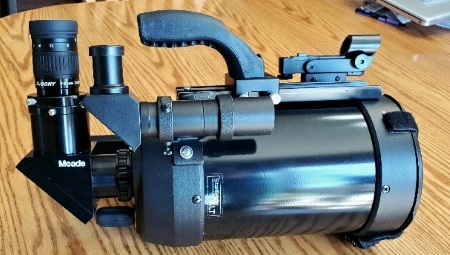

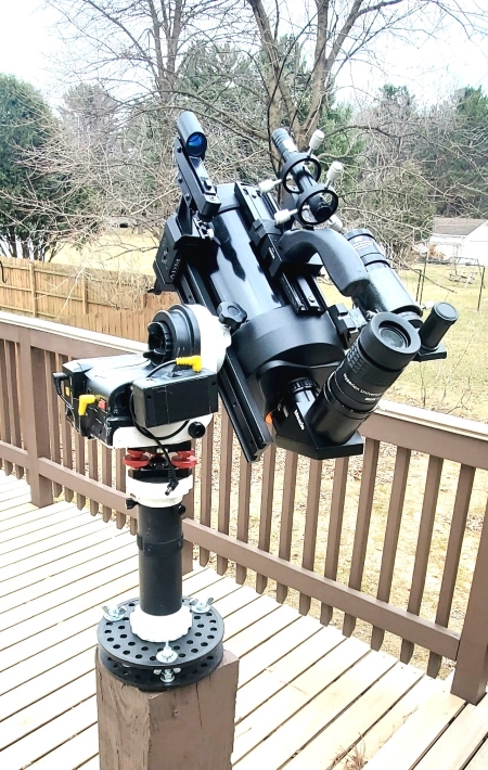

I kind of prefer the focuser at the bottom of my C5. Mine is the black C5 spotting scope so it comes stock with the rail on the "bottom" which works perfectly on the left as well. I bought a longer rail, and moved the stock rail to the top for an extra mounting rail and handle.
