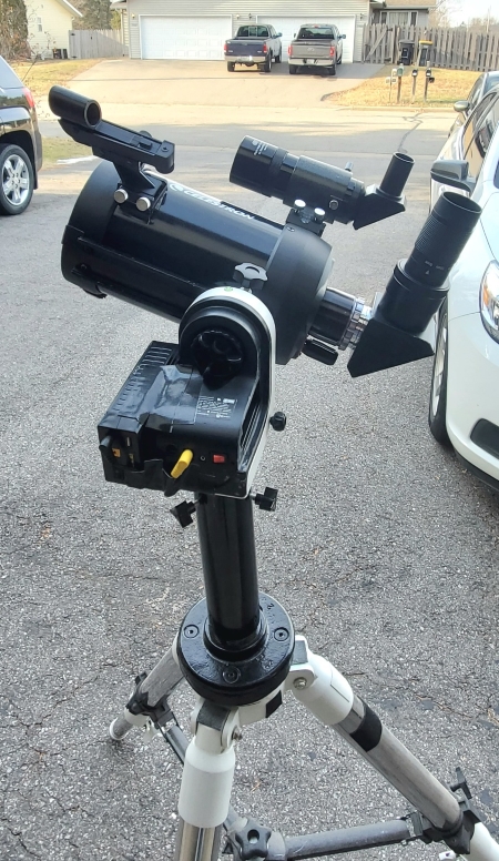

My favorite mount was the Stellarvue MC2, but I really wanted tracking. There is very little out there in the way of simple, small lightweight Alt-Az mounts with tracking, unless you spend a small fortune. Which is why I bought the AZGTi mount.
I've used my AZGTi with some scopes a little over the payload. It's a little sticky/fussy in Azimuth movement manually (the heavier the scope), but I basically only use it manually with the Point and Track (no need to polar align, just make sure it's level). You point it at the object, tell the SynScan app what the object is, then click "Point and Track". I almost never polar align it (not even for GoTo).
For finer movement, I just use the keypad in the wireless SynScan Pro app (which eliminates the sticky Azimuth manual movement).
I currently use it with my C5...
But also have used it with a much heavier scope setups...
An ETX125 with Wegat back, 2" focuser and 2" diagonal, 8X50 RACI, heavy rings...about 12.5 lbs.

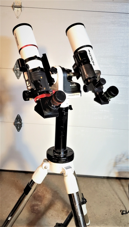

Dual mounted (with a mod to the CW side) using my AT72EDII and ST80 on the CW side)...

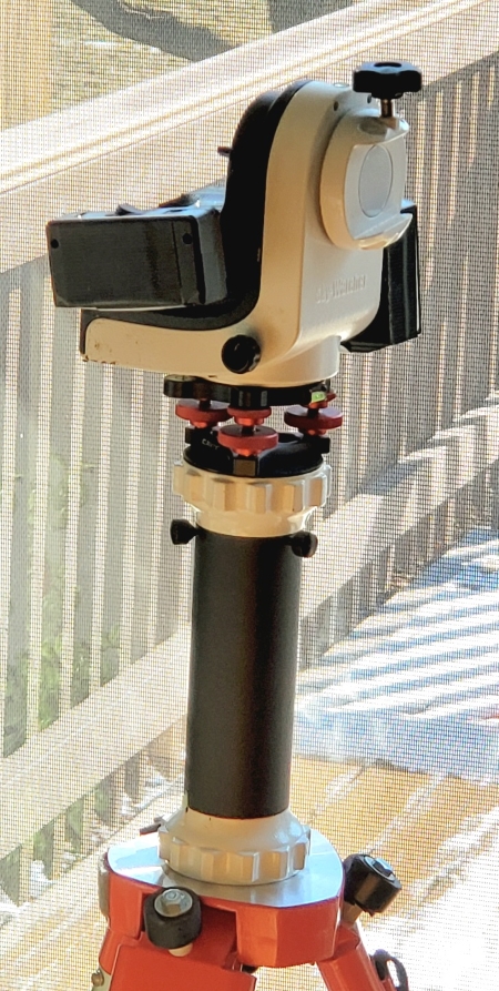

I have the same type of leveler under my AZGTi. Mine is an Apertura, but basically the same. Makes it so much easier to level than messing around with tripod legs...

Well, in actual use, only the AT72EDII is part of the payload. The ST80 is on the CW side so it doesn't count against the payload at all. In fact it balances it out better. But I had to modify it a bit to use as a dual mount. Nothing irreversible as it uses the same threaded rod a Skywatcher CW would. I just added a saddle to it for the ST80 instead of a traditional CW.
I seldom use it that though. I sold the ST80 and only use my C5 as of late.

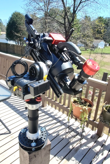

I use the AzGti with a SVX090T. That is sitting at about 11 lbs of payload before adding the 1.25 prism diagonal and the Baader Mark IV eyepiece. This has been on the tripod that comes with the mount.  Sometimes I add a PVS-14 night vision onto that. The system tracks well for visual and Alt-Az mode. I did not like the stability when I added the wedge.
I have a fixed pier that I can put the mount and telescope on and do EAA with an ASI533mc pro. It works for me, but my pictures are not the same quality as the serious astrophotography people produce. Again this is all in Alt-Az mode.
Stability comes more from what the AZGTi is mounted on than the mounthead itself.
I use my own solid tripods or my deck pier...
Surveyor tripod...
2" steel legged tripod...
Deck Pier...
