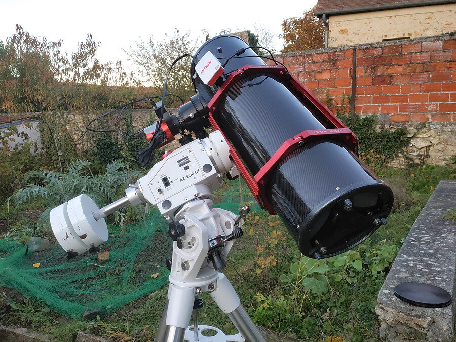

It's not too short with a small pixels camera (more specifically, cameras based on the IMX183 or IMX294 sensor )
Small galaxies are no problem:
https://www.cloudyni...axies-in-draco/
https://www.cloudyni...-galaxy-arp-84/
https://www.cloudyni...-1-and-arp-285/
neither are gravitationnal arcs of galaxies 7billions light-years away wink.gif
https://www.cloudyni...bortle-7-skies/
Clear skies,
Dan
Regarding planetary imaging, an f/4 newtonian is not more obstructed than an SCT, and has no chromatic aberrations unlike SCTs, so with a good 5x barlow it should work well.

#46 Dan_I
Dan_I
  • Posts: 1,669
  • Joined: 22 Sep 2010
  • Loc: France
Posted 07 September 2024 - 06:54 AM
Anyway, my EQ6-R can not deal with those longer focal length anyway. Even the 800 mm of the 8 inch quattro might be too much.
An EQ6-R is perfectly adequate to handle a 8" f/4, there're plenty of great images taken with this combo.
And don't let the OTA length differences fool you. It is true than an 8" RC OTA is shorter than an 8" f/4 newt but:
With the newt the imaging train load is very close to the axes of the mount:
IMG_20211028_182604.jpg.c5294c291f0625dc
While the RC needs several extension tubes to reach focus, so a large moment arm with a heavy camera:
Clear skies,
Dan
  • Spaceman 56 likes this
#47 Oort Cloud
Oort Cloud
  • Posts: 6,944
  • Joined: 19 Nov 2020
  • Loc: New Jersey, USA
Posted 07 September 2024 - 11:09 AM
Clear skies,
Dan
I agree, the EQ6-r can definitely handle an 8" Newtonian. But unlike a small refractor, it will need precise balance, and relatively low wind speed, or shelter from wind in an obsy. An 8" newt is like a giant sail compared to, for example, a small to medium sized refractor.
Moment arm, aerodynamics, balance. They all have a hand to play too, not just weight and focal length.
