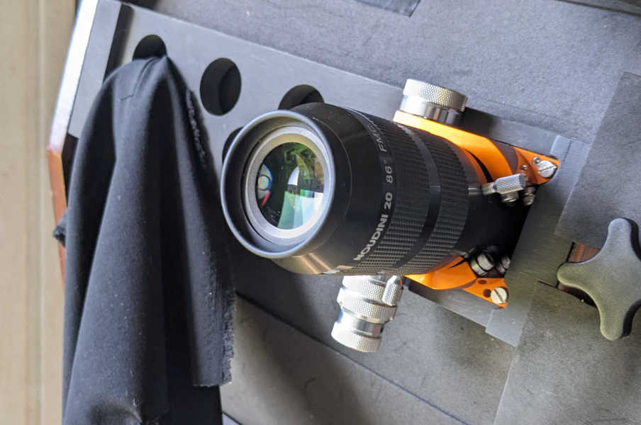

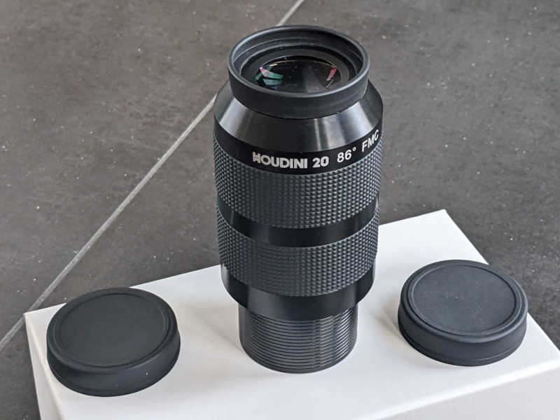

Santa came early this year – ten days ago I received the following package:
This is a prototype of the Houdini 20 mm 86° coma-correcting eyepiece using my optical design.
We've been discussing coma-correcting eyepieces on Cloudy Nights, most recently in the thread I started 4 months ago
I never expected that this dream would become a reality so quickly!

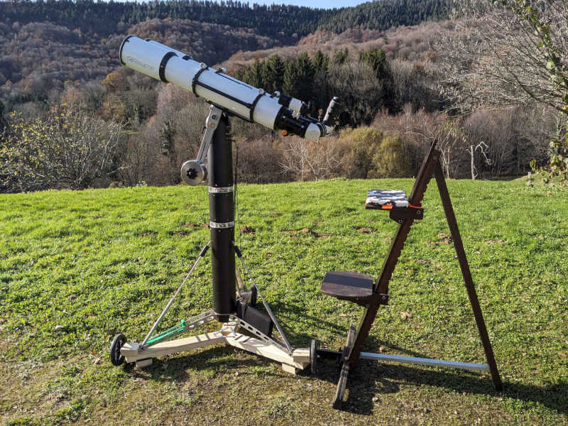

I've been testing the Houdini 20 with my 1100 mm (43") f/3.6 and 25" f/5 Newtonian telescopes, and with a 6" f/8 refractor binoscope for the past week.
I spent a first night with the 1100 mm f/3.6 constantly switching between the Houdini 20 and the Ethos 21 with Paracorr in (200X with 86° field of view, and 220X with 100° field of view, respectively).
Among others, Saturn, Jupiter, M33 (the nova was not visible), NGC 7789, M35 + NGC 2157, M1, M42, Mars, and Sirius B passed in review.

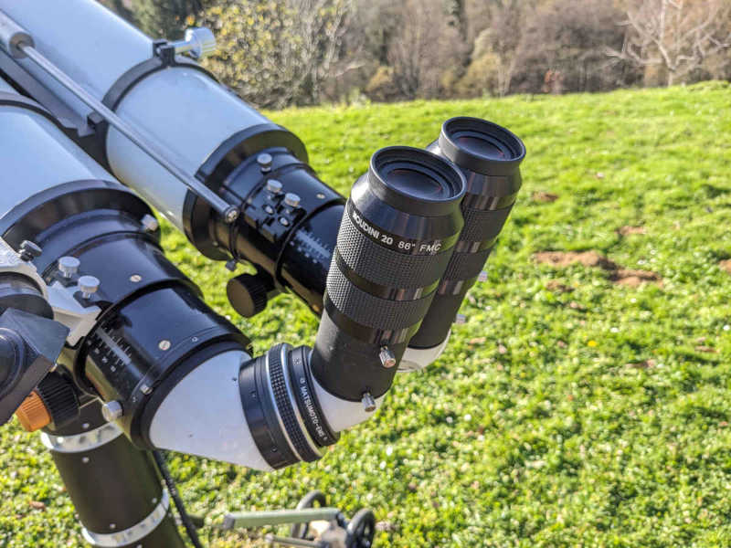

The third night I used the 6" f/8 binoscope. My interpupillary distance is large enough for binoviewing with the Houdini 20 (64 mm in diameter), but it's a challenge to squeeze my nose between the eyepieces. With some squirming and discomfort, I managed to see the 86° field with both eyes (the edge peripherally, of course).
152%20mm%20Binoscope%20met%20Houdini%202
Houdini%2020%20in%20152%20mm%20Binoscope
The Houdini 20 offers 60X and almost 1.5° field in this setup. I got some great views of many large objects including M45 (Pleiades), M42 (Orion Nebula), M31 (Andromeda), M81 + M82, NGC 2344 (Rosette Nebula), M33, NGC 891, NGC 7789.
The eyepiece shows a sharp, flat image with some inverted coma at the edge, but not much. The edge sharpness is actually about the same as the Panoptic 24. This confirms that the Houdini 20 works well at f/8 in any type of telescope.

Nominal eye relief for the center of the field is 19.7 mm, measured from the glass.
The eye lens center is recessed about 3.5 mm from the upper metal surface of the eyepiece (if you remove the eye guard), so the effective eye relief should be about 16 mm.
If you look at the pictures above, the eye guard on the prototype was too short. It will be 4 mm longer in the production run.

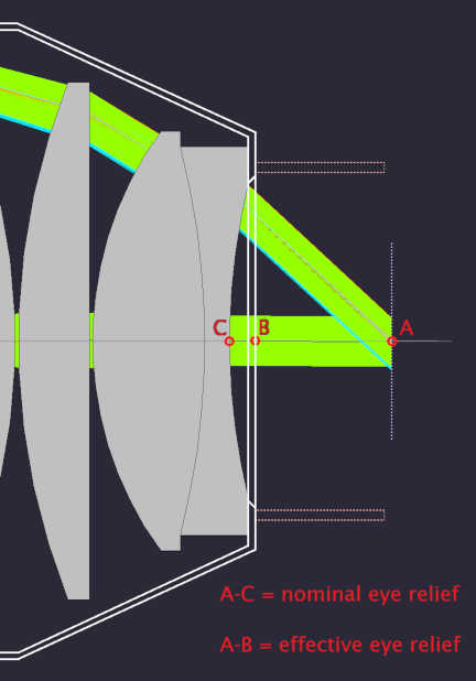

For the eye relief, I hope the following diagram will help. It shows a cross section of the upper part of the eyepiece.
The green light rays come from the left and converge in point A.
You are looking right to left with your eye at point A, so that you can see the whole field.
The distance A-C is the nominal eye relief, measured between the eye in A and the glass element in C.
The distance A-B is the effective eye relief, measured between the eye in A and the upper part of the eyepiece in B against which you will press your eyeglasses.

Careful!  If the eyecup is taller, when it folds down it will stick up quite a bit above the top surface of the aluminum.
That would reduce the effective eye relief of the eyepiece and might make it unusable by glasses wearers.
As it is, your effective eye relief of 19.7-3.5=16.2mm is OK for most glasses wearers, but, you forgot the rubber above the aluminum surface, likely a mm.
That makes the glasses user's eye relief 15.2mm, which is about the same as the Pentax XW and  some other eyepieces that are glasses-compatible.
If you make the eyecup 2mm taller, it will stick up above the aluminum surface more than the one that is there, and might make the eyepiece a non-viable candidate for glasses use.
Thanks for the very useful comment, Don. I'll make sure to follow this up, but I'm not too worried.
My point of comparison is the eye guard of the 30 mm UFF (also made by KUO) which is 2 mm taller than the production eye guard of the Houdini 20 (this matches the specified eye relief, which is 22 mm for the UFF 30 and 20 mm for the Houdini 20).
I can fold that eye guard as flat as the shorter eye guard on the Houdini 20 prototype, so I would not really expect any issues.

Looking forward to this.  I for one like long eyecups.  Will this design in any way restrict the eyepiece to only fast scopes?  I have a 20” f/4.3 Starmaster but also a Mewlon 180 f/12.

The eyepiece will work well with any telescope with longer focal ratio, f/8 and above are fine. At long focal ratios the parabolic coma correction is not visible.
The Houdini 20 will behave like an excellent "normal" eyepiece in your Mewlon 180 f/12.
This is amazing. Many of us have a big, fast dob, plus some smaller, much slower scopes. A wide-field eyepiece that can work well in both, without the need of additional expense and hassle of a coma corrector, is going to be a major breakthrough and become hugely popular (depending on the final price).
Pleasepleaseplease consider making a 24mm ~65° version for smaller telescopes with 1.25" only focusers.
It would be best to have two eyecups come with it, one for each crowd.  For me, short eyecups (or even no eyecups) are difficult to use because it makes finding and holding eye placement more difficult and allows more stray light in.
