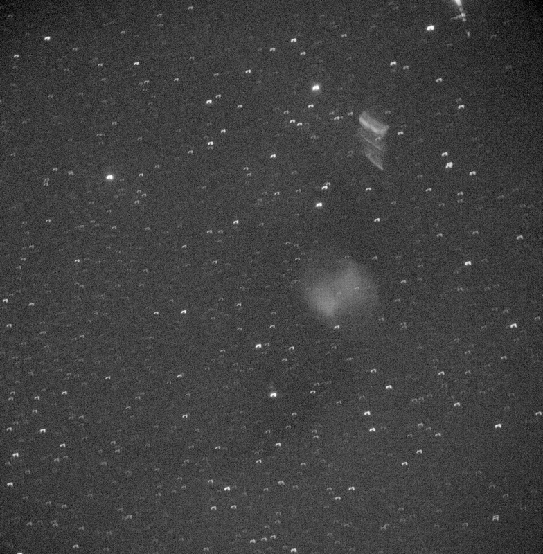

Just randomly picking a few of your files, your stars aren't "stars":
Your stars need to be points, not lines, or squiqqly things to stack.
How are you taking these pics?
In the stacking with the script, it says there are 405 pics, but in the folder you uploaded there are almost 500 pics.  Are these the same pics as what you ran through the script?

Registration 492 pic, 355 registered, 157 failed.
Script Stacking 283 stacked, 209 failed.
Light.zip 492 files.
Yes, you can try to run the script, around a half must pass.
I know that sessions have bad stars shape, but it is one of the better m27 what I recorded (but don't have many).
I was taking these pics with my phone (see signature) and Ex.15sec ISO 50.
What I figured out is when you use multiple registration, any next time number of pictures decrease, so like ex. 492 at start registration, 380 at next registration, 360 at next... all to the fixed number where registration finished 100%. So, maybe that's way show 283 stacked to me.
Edited by Smurf, 22 January 2025 - 11:50 AM.
#24 Smurf
Smurf
  • Posts: 85
  • Joined: 03 Jun 2023
  • Loc: Croatia
Posted 25 January 2025 - 07:10 AM
@lock042 What you say?
#25 lock042
lock042
    Siril astronomical image processing software
  • Posts: 586
  • Joined: 03 Nov 2015
Posted 25 January 2025 - 09:04 AM
With some adjustments in the star detection, I get:
14:10:37: Total: 5 failed, 222 registered.
14:10:37: Execution time: 32.29 s
Then I cropped the sequence as I told you.
After that, only one image has a NULL MAD. I unchecked this image from the processing.
Next, stacking worked (I normalized the output).
After stacking, I cropped the image to remove all black edges.
Next, background extraction, manual color calibration, starless and GHS on it (+saturation with GHS).
Finally, star recompilation.
All done in Siril
