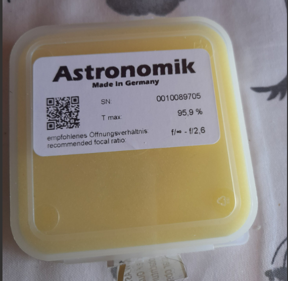

So, I bought a new one for 99 euro.
Don't know how long these kind of things can stay on the shelf, before selling. But I assume I have a new (after 2016) one.
Do you know how you can see the difference between the old / new one? (added some pictures)
Hope I got the right one, because it was not easy to get one. Customs in Norway are terrible!filter1.pngfilter2.pngfilter3.png

If you ask Astronomik, they can tell you all about the filter from the serial number. P.S. their stickers yellow after a couple years and yours are pure white.

I got new and old ones(Profi type, which cut IR), I could not see any difference. You will really enjoy it 🙂. Next will be the OIII
