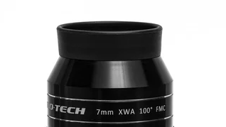

I've had all my eyepieces for several years, now and used them frequently in a 12.5" f/5 (f/5.75 with Paracorr) and a 4" f/7 triplet apo.
All the eyepieces have been used often, with the 3.7mm Ethos seeing the least use, but still used many times in both scopes.
Sites have varied from 20.9-21.8mpsas skies.
I have some seat-of-the-pants comments, and the only reason I make this post is to see if other users have noted the same things and to note some misgivings.
There is no perfect eyepiece, and an eyepiece need not be perfect to be enjoyable to use.  My use is 99.9% deep sky use, not planets and Moon.
All but one of these eyepieces exhibited slight chromatic smear of star images at the edge, but that aberration is so common in eyepieces I just ignore it unless it is egregious, which it isn't in any of these eyepieces.
I wouldn't hesitate to recommend any of them to another observer, though I might not recommend some of them for an f/3 scope user.
So, I will post what I like, and what I don't like about each eyepiece.  If the eyepiece is glasses compatible, my comments include glasses use because without glasses I cannot honestly evaluate an eyepiece.
Ditto the use of a Paracorr in the dob.  Without a Paracorr, I could not evaluate the edge of the field in the eyepieces because I would blame poor image quality on the eyepiece when it is really the scope's fault.
These will solely be my opinions and not applicable to other scopes, users, and sites.
Feel free to disagree or point out something I omitted.  Do point out what scope you use, however.
30mm APM Ultra Flat Field:
What I like:
  • Flat field
  • sharp star images
  • superb contrast
  • ease of use
  • lightness of weight for its focal length
  • edge of field control of aberrations (No CA or Astigmatism!)
  • cheap price
  • no lower barrel undercut
What I don't like:
  • blue stars have less luster than in, say, the 31mm Nagler
  • only 70° field
22mm Tele Vue Nagler Type 4
What I like:
  • ease of use--very comfortable.
  • sharp star images
  • ultra-wide field
  • Instadjust eyeguard when sharing the view with others--<1 second, one-hand adjustment.
  • brightness of the star images
  • immersion in the field
What I don't like:
  • the low power it produces, which means it doesn't get used as much as other eyepieces
  • weight.  This is one dense eyepiece.
17.5mm (17.2mm) Baader Morpheus
What I like:
  • comfortable to use
  • 98% of the field very sharp
  • good contrast
  • very light weight
  • kerfs on lower barrel
What I don't like:
  • narrower apparent field than all the other Morpheus eyepieces
  • eye relief a bit too long and I have to use o-rings under the eyecup to make it the same as my other eyepieces
  • stars in the last 2° of field astigmatic
  • No-Man's Land for magnification--always too low or too high in my scopes.
14mm (13.9mm) Baader Morpheus
What I like:
  • superb contrast
  • superb light transmission
  • excellent sharpness until very close to the edge.
  • ultrawide field
  • light weight
  • perfect eye relief for me with my glasses right out of the box
What I don't like:
  • that it isn't a 13mm.  14mm is just a *trace* too low a magnification
  • slight edge of field CA.
12.5mm (12.4mm) Baader Morpheus
What I like:
  • One of the sharpest [star images] eyepieces I've ever used.  Globular clusters resolve to the very core.
  • superb contrast.  About as little scattered light in the eyepiece as I've seen.
  • a great magnification for lots of objects.
  • ultrawide field
  • ease of use
  • light weight
What I don't like:
  • too close to my 11mm in magnification
  • seems a bit darker than my 11mm and 14mm
  • 12.0mm would have fit my magnification scheme a little better.
11mm Tele Vue Apollo11
What I like:
  • 85° field
  • image contrast!
  • very sharp star images
  • light transmission
  • eye relief
  • zero vignetting
  • the thinnest blue edge to the field that I've ever seen in an eyepiece
What I don't like:
  • the 2" steel adapter.  It could/should have been aluminum to save weight.
  • slight astigmatism at the very edge
  • field stop not in focus for my eye.
  • very slight field curvature in my scope.
  • it's not a 10mm
  • undercuts on 1.25" barrel and 2" adapter
9mm (8.9mm) Baader Morpheus
What I like:
  • Ultrawide field
  • exit pupil position narrows visible top of the eyepiece to a thin black ring around the field for a floating in air effect
  • light weight
  • very good contrast
  • sharp star images
  • works great on a lot of DSOs
  • very bright image for its focal length
What I don't like:
  • eye relief was too long until I tamed it with an o-ring under the eyecup.
  • edge of field CA
  • *slightly* softer star images than the Morpheus focal lengths on either side.
7mm APM XWA
What I like:
  • 100° field
  • very sharp star images to *just* shy of the field stop
  • Superb contrast
  • excellent control of light scatter
  • entire field is easy to use
  • smooth lower barrel and smooth 2" adapter--no undercuts
  • light weight for focal length and field of view--can use as a 1.25" with no risk to the barrel.
What I don't like:
  • needs another mm of eye relief.
6.5mm (6.7mm) Baader Morpheus
What I like:
  • superb contrast
  • ultrawide field (79°--the widest of the Morpheus)
  • light weight
What I don't like:
  • magnification doesn't match my scopes well.
  • edge of field CA
6.0mm Tele Vue Ethos
What I like:
  • ultra sharp right to the field stop
  • superb contrast
  • easy to use without glasses
  • no noticeable astigmatism at all
  • extremely slight CA right near the edge
  • light weight
  • field seems wider than 100°
  • used as 1.25", there is no undercut on the barrel
What I don't like:
  • the 2" skirt has an undercut
  • the 2" skirt is not removable
  • it can't be used as a 2" eyepiece in the Paracorr without adding a long barrel extender
4.5mm (4.8mm) Baader Morpheus
What I like:
  • the sharpest of all the Morpheus
  • flat field
  • superb color rendition for planetary nebulae
  • light weight
  • ultrawide field
What I don't like
  • slight CA at the edge of the field
  • slight barrel distortion (noted in daylight--at night the field is too narrow to really notice)
3.7mm Tele Vue Ethos SX
What I like:
  • excellent contrast results in very faint details seen in planetary nebulae
  • hyper-wide 110° field results in longer views between nudges of the scope
  • light weight even though a long eyepiece
  • CA seen only at/near the very edge
What I don't like:
  • 110° field was unnecessary and 100° would have been enough, and less head movement would have been required.
  • the shortest eye relief of the Ethos series.  It's OK, but less than the 6-21mm Ethos.

7mm APM XWA
What I like:
  • 100° field
  • Superb contrast
What I don't like:

Don,  for the 7XWA...
If you have a spare Tele Vue rubber eye cup lying around, replace the stock XWA eye cup with the Tele Vue one. You'll gain 1mm of effective eye relief. That's what I did on mine. It's wonderful to use.
See the little ridges in the 2" and 1.25" barrels: https://cdn.shopligh...eg-eyepiece.jpg
Those are kerfs (safety kerfs). If the eyepiece is loose in the focuser, it will likely tilt, and when it tilts, the kerfs will snag somewhere on the edge of the focuser or adapter, thereby potentially preventing it from falling out. They're less hostile to the user than undercuts, but are not quite as good a safety mechanism as an undercut.
I always use the eyecup on the 7mm folded down, so a shorter eyecup would have no effect.

The XWA has a different eye cup than the Optimus/Tele Vue.
I think what CrazyPanda is trying to say is that folded down the Tele Vue/Optimus style eyecup may fold down a little flatter.
I replaced the XWA eyecup with an Optimus eyecup and top cap. Not to gain eye relief but for storage and uniformity of my hyperwide set. The XWA has a smaller cap that won't fit if the eyecup is folded down. I like to store them with the eyecup folded down. Now I can.
Same here, I never use eye cups up. But folded down you you still gain about 1mm (I measured with caliper depth gauge).
The stock XWA eye cup is rather thick AND wide when folded down. This not only means it reduces effective eye relief because of its thickness, but the extra width means it makes contact with your face at a point that further reduces your ability to get closer to the eye lens (depending on facial geometry).
Tele Vue eye cups when folded down are not only thinner, but narrower. You can get your eye closer the eye lens. I estimate at least 1mm gain in effective eye relief, maybe a bit more.
Take an eye guard off one of your Ethoi and put it on the XWA and try it (folded down). I think you'll find it grants you the 1mm more eye relief you're looking for. It did for me. It made the XWA more comfortable than my 8 and 6 Ethoi.
I'll post some pictures and measurements later today when I can.
