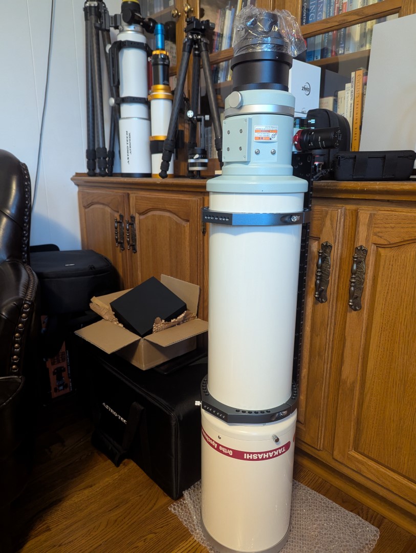

The wife left the house 20 minutes before the brown truck pulled up. I've got everything unpacked and put away. She'll be home soon. Wish me luck.
You removed the counterweight ring???  I imagine it must be terribly front-heavy now.  Is that not so?
Yea, it sure is, but once the imaging train is installed it'll be fine.

What did you decide you will you mount it on?  I like the weight ring on no matter what I have on the focuser; the shorter that end of the scope is, the longer I can run without a pier strike/flip.  And for visual (shocked.gif ), the eyepiece is higher.  But that changes if your mount is marginal...that ring is heavy!
It'll be going on a Mach2. That's a good point about avoiding a pier strike. I'll have to consider that when I mount it. I can always put it back on if it helps.

With the TOA150, I would recommend the AP1100 over the Mach2.  The TOA is very long and heavy and the weight is excessively distributed to the front lens cell, giving it a very long lever arm.
I have both an AP1100 and Mach2 and have a similar size scope (though more than 100mm longer), vintage SV152 w/ LZOS lens cell.  I am MUCH more comfortable with my SV152 on the AP1100.  I feel the SV152 and TOA150 are pushing the edge of the Mach2's performance envelope, due to its length and weight distribution.   My AP1100 with my SV152 beast consistently guides better than my smaller OTAs do on my Mach2.  The times in which the Mach2 perform better is when it is windy.
Sorry, I see that you already have a Mach2.  Be careful balancing the TOA, as the Mach2 is much more sensitive to balance than the AP1100.  I would recommend getting a 19" Losmandy plate and add as much weight as you can to the rear to offset the heavy front.  Do everything you can to have the TOA ride as high in the saddle as possible to reduce the possibility on contacting the tripod/pier.   With the TOA you could either get the Tak ring weight, or as I did put a Losmandy weighted clamp on the rear of the plate.  Mine also has a 3rd ring that I put on the rear with some my USB hub, to further get more weight to the rear.

Yea, too late.  I do have the 24" Losmandy plate and plan to hang everything off the rear. I have the counterweight as well.
Thanks for the tips.
