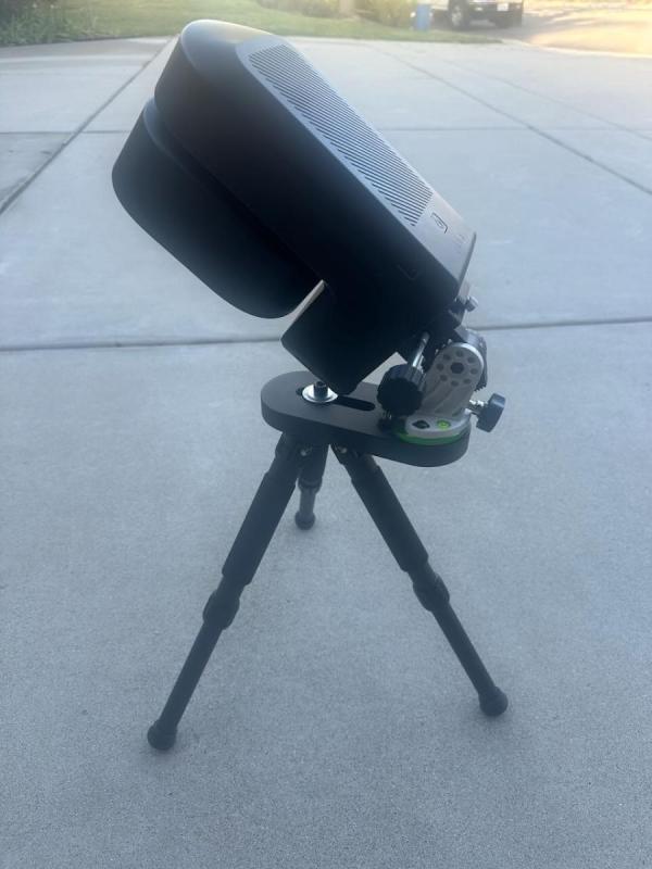

I am using the skywatcher wedge with the original S50 tripod - but 3D printed a mounting plate to move the center of gravity closer to the center of the tripod.  I will say that after using this a number of times I only really use the altitude adjustment on the wedge - for azimuth I just nudge the tripod left or right.   It is pretty easy to get "near perfect" alignment - or at least what the app tells you is near perfect.
  • Bill Jensen, SteveFour86 and roelb like this
#17 SteveFour86
SteveFour86
  • Posts: 413
  • Joined: 14 Dec 2009
  • Loc: Bay City, OR
Posted 11 April 2025 - 12:37 AM
Does this wedge include a plate with a screw for seestar as well or do i get that separately?
Yes you will need a plate. Something like this.   https://www.amazon.c..._fed_asin_title
#18 SteveFour86
SteveFour86
  • Posts: 413
  • Loc: Bay City, OR
Posted 11 April 2025 - 12:39 AM
Love that plate. Can’t afford a 3d printer.
#19 Tom K
Tom K
  • Posts: 1,165
  • Joined: 19 Jan 2010
  • Loc: Escondido, CA
Posted 11 April 2025 - 06:41 AM
I am confident that a similar plate could be fashioned out of some scrap plywood with basic hand tools as well.
  • JReed likes this
