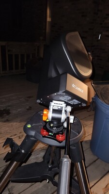

Here is a photo of my SeeStar 50 on the Celestron Evolution Mount
Evolution Tripod with SeeStar 50 in Equatorial Mode
Hey Amazed, I am curious is that fluid head mount this one?
https://a.co/d/jiR4i0c
How did you attached the plate to the Seestar 3/8" bolt on the bottom? How is this fluid mount working for you?

Yes it is👍

Yes it is
How does it do in terms of the equatorial mode for the Seestar?

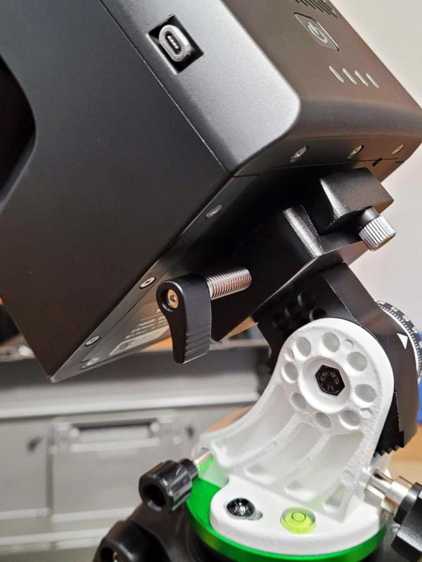

I've found my perfect solution to the locking screw issue when using the Skywatcher wedge with the Seestar S50.
I'm using a spring-loaded adjustable knob I purchased from amazon.  With the top of the knob parallel to the dovetail plate, it slides in easily. Turning the knob just over 1/4 turn locks the dovetail securely.  It's an M8 thread, and the 30mm length doesn't interfere with the cord from my external power supply or the bottom of the S50.
  • SteveFour86, roelb, dsjames and 2 others like this

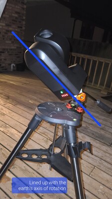

I have no issues. I use the Seestar app on the cell phone to adjust the altitude first. The let it scan the sky. When satisfied it tells me which way to rotate the scope. There is a nob to loosen and i manual turn it then lock it down.
The wedge sits on my red leveling device. That i use just to raise the camera upward so when it spins it is clear of the base
My Tripod Set Up

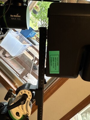

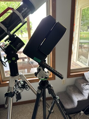

Seestar in EQ mode on 200mm rail
Seestar mount in EQ mode
Used a rail to achieve good balance with an old Manfrotto tripod.  Used a washer so the feet of the Seestar clear the rail.  Looking forward to using it.
Tony
  • SteveFour86 likes this

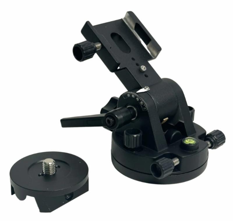

Seestar EQ Wedge for your Seestar
https://milehighastr...q-balance-wedge

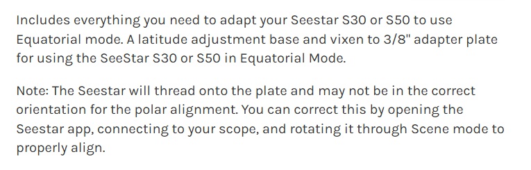

Per Mile High Astro website on the Seestar EQ wedge:
