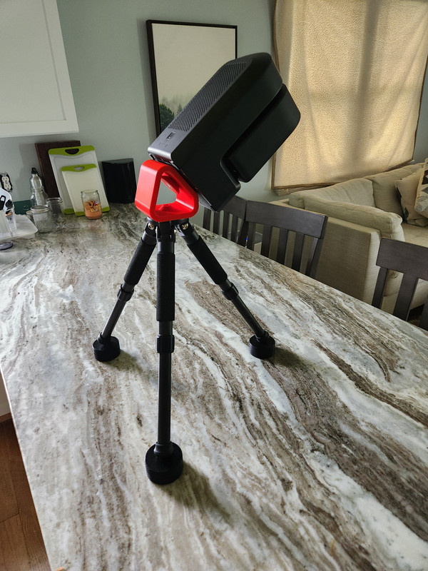

Sky-Watcher here with the eq balance arm from Peterson Engineering. They also sell an easy-to-use wedge that simplifies polar alignment.
That looks like a good option for viewing from a fixed home location. When traveling, a second adjustable type could be good to have also.
I am using a fixed 3D printed wedge that was made by another CNer. I will be picking up a second adjustable travel wedge soon. I also have one of those panoramic bases coming which should make tweaking EQ much easier than nudging the tripod!
Here is "R2D2" on its wedge...
