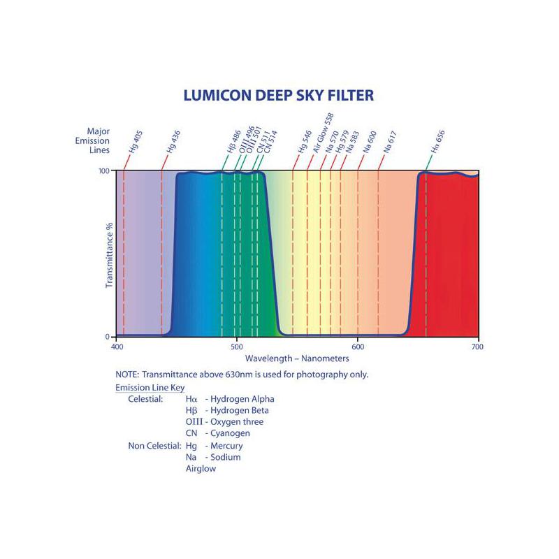

#6 CrazyPanda
CrazyPanda
  • Posts: 6,796
  • Joined: 30 Sep 2012
Posted 28 March 2025 - 01:50 PM
The Lumicon Deep Sky filter may help with seeing some galaxies as suggested in their brochure. It has a  cyan color effect I find.
Here's the graph.
Looks like it clobbers sodium and mercury vapor lighting. So if you live in an area with sodium and mercury vapor lighting, then in theory this filter would suppress disproportionately more light pollution and air glow than light from the galaxy.
But if you live in an area with broad spectrum LED lighting, this filter will probably do more harm than good for the reasons Redbetter mentioned.
Edited by CrazyPanda, 28 March 2025 - 02:04 PM.
  • j.gardavsky likes this
