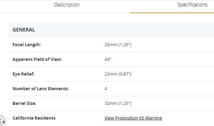

Sir Starman1, I really want to get the Celestron Omni Plossl 32mm, but here is the screenshot of the Celestron website itself that it give the spec for their Omni Plossl 32mm, it say it 44 degree only, not 50 deg like how it advertise Plossl 50 deg.

Posted 09 May 2025 - 06:55 PM
32mm Plössls vary from 42-43° to 49.5°, but I've never seen one that was 50° or more.
At 45°, the edge will be sharp, unvignetted, and well-corrected.
At 49.5°, the edge might be a little blurry, or slightly vignetted, or less well corrected.
One of the best I've used or owned was the 45° Baader 32mm Plössl in the "Q" Series.
Another exceptional one was the Meade Series 4000 32mm 5-element Super Plössl, made in Japan by Kowa (no eyecup).  By today's standards, it would not equal the coatings on current ones.
To be honest, though, unless the eyepiece is really poor, the on-axis images of most 32mm Plössls are pretty close to the same.

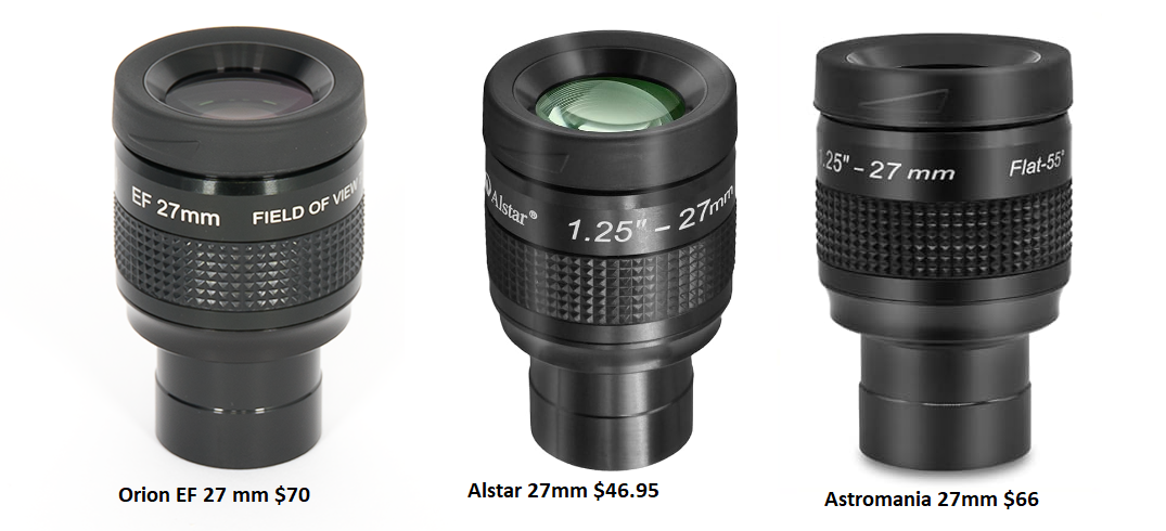

Sir Starman1, can you help look at this screenshot below, basically these are same eyepieces right?
Orion EF 27mm
Astromania 27mm
Alstar 27mm
It looks alike, same housing, except different writing brands on it. If it the same then I get the cheapest price one then. I can get it under Alstar for like $25 cheaper.
If I get the copycat cheapest one in there, would the inside lens glass inside be different? I knlow Orion is a brand, but it the most expensive out of the three.
Edited by MrsM75, 14 May 2025 - 09:19 PM.

Posted 14 May 2025 - 09:32 PM
Orion EF 27mm
Astromania 27mm
Alstar 27mm
They're the same.
