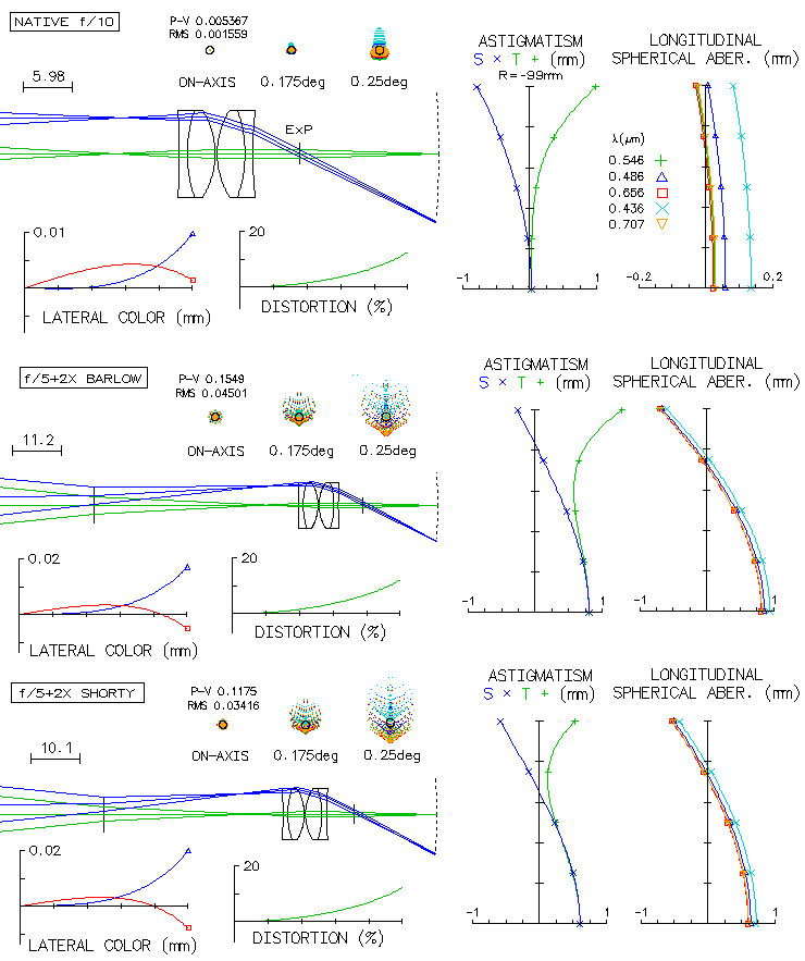

Now I'm itching to up the magnification a bit but I despise tiny focal length eyepieces
DeLites and TOEs will reach the magnifications you want while maintaining some comfort in the process, without compromising quality in any significant way.
In theory a long native focal ratio is better for simple orthos and plossls than barlowing a short focal ratio telescope if you go by these spot diagrams:
I don't know what that means in terms of a telecentric though - because a telecentric does not have diverging light cones.
Many planetary observers swear by the 2.5x Tele Vue PowerMate.
  • KeithC and Tangerman like this
