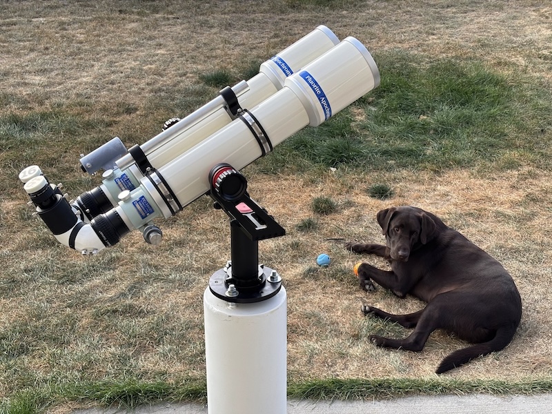

I have not used this mount myself but I would take a look at the TTS-160 Panther Lite.
Manual only, has the option of top-mounting, weighs 7 kg (15.4 lbs) but has a capacity of 25 kg (55.1 lbs) in single top-mounted configuration. Photo from TTS.
