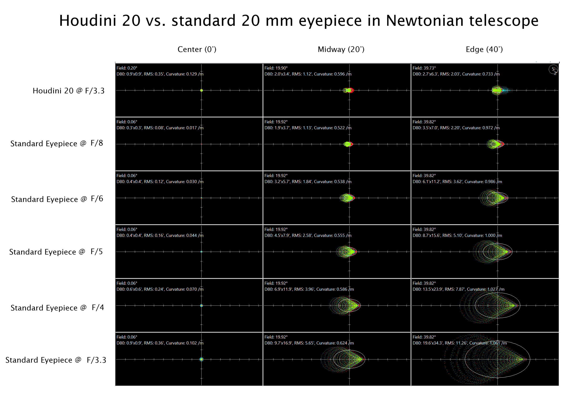

Most of the optimizations are done at F/4, but the designs work very well down to F/3 (and maybe below, I've never checked).
There is no "under-correction" at F/3, coma is still almost completely removed, but the main problem becomes spherical aberration. SA increases with the inverse cube of the focal ratio, which means that F/3 is more than twice as bad as F/4. And a 20 mm eyepiece at F/3 gives a very large exit pupil (almost 7mm), which increases the difficulty even more.
Nevertheless, the performance should be very good. I've posted some graphs in another thread to show the performance at different focal ratios: https://www.cloudyni...ity/?p=13880666
In the second graph of that post, you can see that the Houdini 20 at F/3.3 performs better than an uncorrected view at F/8.
Edited by Houdini, 26 April 2025 - 06:59 PM.

#45 Houdini
Houdini
  • Posts: 908
  • Joined: 13 Jul 2007
  • Loc: Europe
Posted 27 April 2025 - 03:40 AM
You can verify that coma increases with the inverse square of the f-number in the second graph of the post I linked above:
This graph: https://cruxis.com/s...ot Diagrams.png
Compare F/8 and F/4 to see approximately the factor of 4.
Or F/6 and F/3.3.
Edited by Houdini, 27 April 2025 - 04:57 AM.
