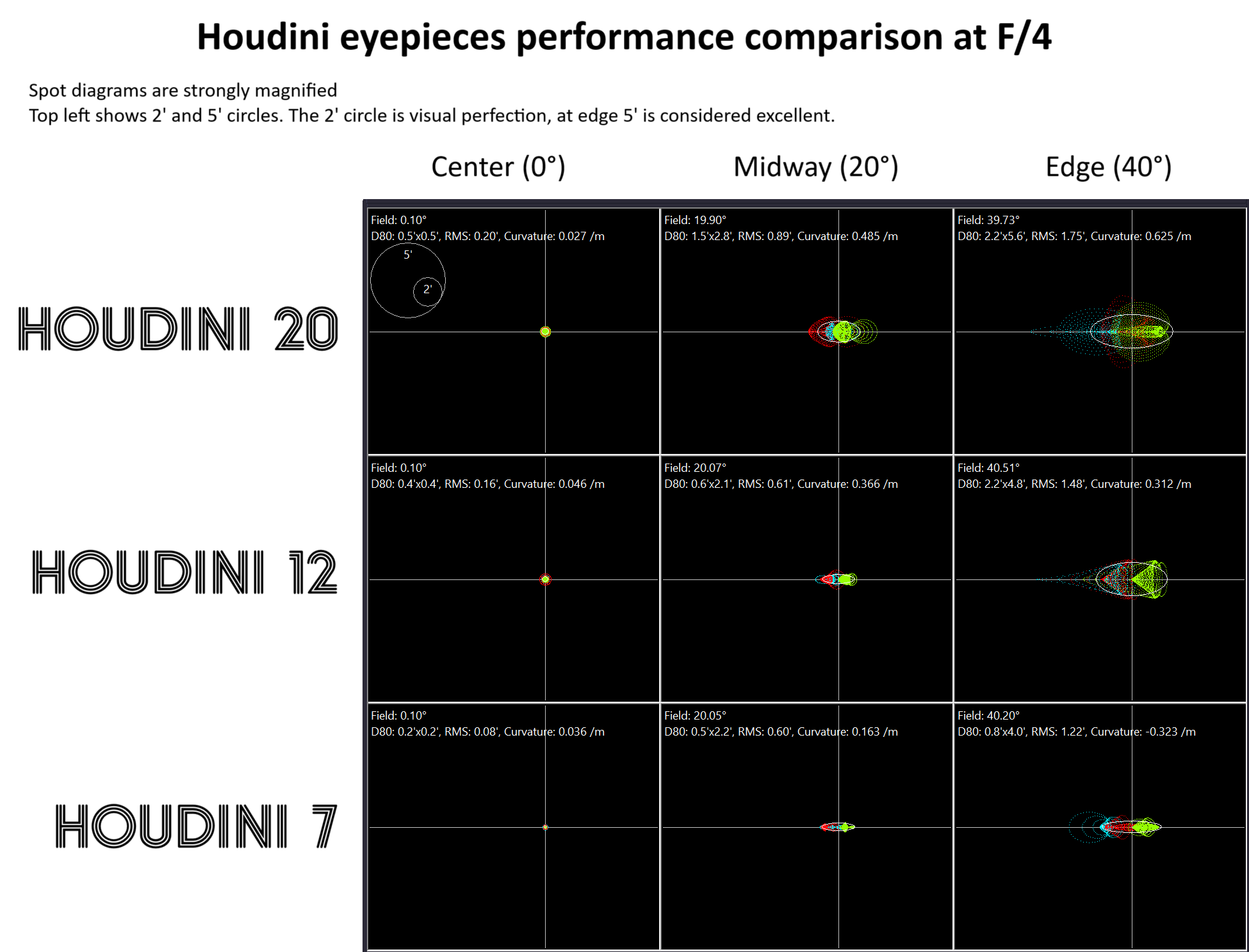

Your Cruxis site has ray traces of coma-corrected eyepieces with focal length 20mm and longer. Have you posted any spot diagrams for the upcoming 12mm and 7mm eyepieces? Perhaps you could link the spot diagrams at f/4 on your website (or maybe it's already there and I just couldn't find it).
The designs on the Cruxis web site are just for illustration, they're not "production" quality, these pages were made about a year ago - before our collaboration with KUO.
But yes, it's a good idea to have a comparison chart for the Houdini eyepieces with the spot diagrams at F/4. I'll prepare a chart and post it on the Houdini Telescopes web site.
EDIT: Below the Houdini 20-12-7 Comparison Chart at F/4.
The Houdini 12 and 7 are very sharp!
Houdini%20Comparison%20Chart%2020-12-7.p
Edited by Houdini, 25 May 2025 - 06:17 AM.
