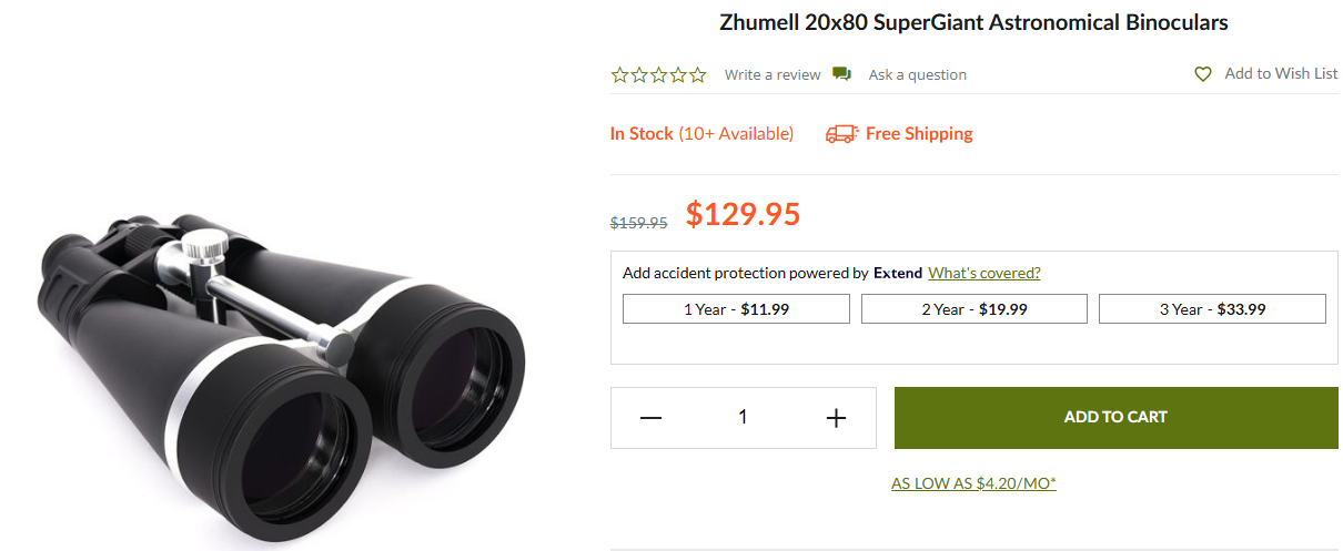

HighPoint Zhumell 20x80 huge binocular $129 free shipping too.
80 I assume it 80mm aperature? It bigger than my 70mm Mak
Should I try one? Seem like a good deal.
https://www.highpoin...ical-binoculars

Inexpensive enough, not much of a risk if they aren't very good, This pair on Canada Amazon is around $110 U.S. (converted from Can) so the price isn't radical.

I had the Orion branded version of that bino, the lasted about a year and something on the inside let loose.  I replaced them with a bino from Oberwerk.  Yes they cost more but they were worth the extra coin.

Also, many of the cheaper 80mm binos have reduced effective aperture in the 72-75mm range. Maybe that's changed in the last few years but it was common 10 years ago. If you do get them, use the flashlight test(make sure it's 12 inches away from eyepiece at least) to check their effective aperture.

My main worry with these would be that they either might not arrive in good collimation due to transport or that collimation would not hold over time.  Also, they are too heavy to use handheld and really need to be mounted on a tripod.

I really hope they didn't use plastic in the eyepiece shells and the objective tubes. I have a bigger  (18x80) astro bino that has the plastic tubes- a bit too flexible to me. The plastic eyepiece shells are more more vulnerable to smaller impact damages than a metal shell would be. I understand they are built to a price point- it's just that the price point isn't necessarily apparent until you need repair, not replacement and that latter is the only option (outside of buying a donor). Pat
