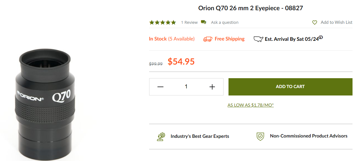

Hi if you scope has 2 inches then try this, I think this is a great price eyepiece, Orion Q70 26 mm 2 Eyepiece, it is 2 inches, and 26mm, and 70 degrees, Orion brand. For $54
HighPoint also have this in 32mm too, 2 inches, 70 degres
https://www.highpoin...-eyepiece-08827

What kind of DSO's do you want to look at? Probably the showpieces for now, nothing over 10 mag, For Open Clusters a 10-13mm, for Globulars 13mm and 6-7mm for a closer look should be good. For Nebulae + a Filter, you're better off getting a 20-26mm, Galaxies and PN's a 10mm.
13mm This one looks perfect for 119.25 Astro-Tech 13mm UWA 82°
I think you'd be fine with a 6.5mm, 13mm and a 20-26mm for now, would add a 10mm later on.
Just my opinion, see what others suggest also.
