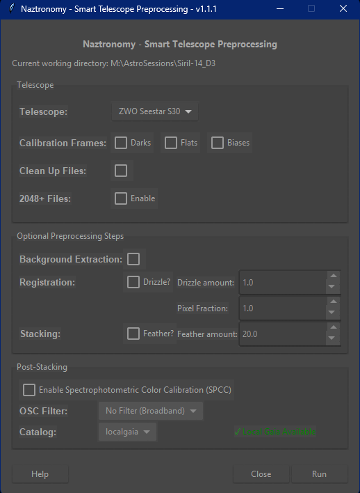

I turned my Seestar preprocessing SSF scripts into a python script that gives you more control and also lets you process Dwarf and Celestron origin images. Note: Origin images are currently not working, I'm looking into it.
Here's a demo video on how this works: https://www.youtube....h?v=E_LIjdVQdSg
You can download the script here: https://github.com/n...t/siril-scripts
Python in Siril is still in beta so there are some workarounds I do in my code but so far it works really well. The video goes over some troubleshooting steps but if anyone tries and runs into issues, let me know.
Future work includes adding calibration frames and more smart scopes to the list (and a better user interface).

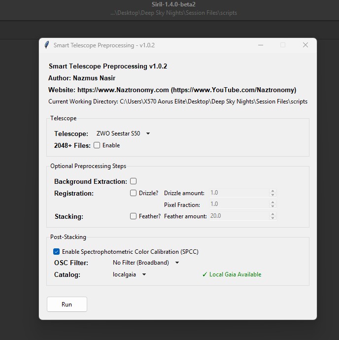

grabbed a handful of subs to test

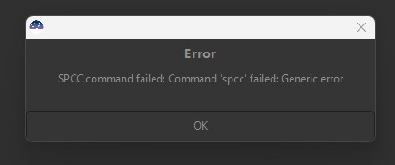

selected key options in the panel and hit run / seems to stack all the images fine but i got this error pop up with a bunch of red text  >>> here is the log thats in red >>>>
i know absolutley nothing about scripting coding or any of that stuff sry frown.gif  ALSO i noticed after i run the script if i want to run it it again i have to reset the working directory everytime , i did reset python  in the preferences several times fingertap.gif
23:21:27: Chunk file not found: C:\Users\X570 Aorus Elite\AppData\Local\siril\siril_cat1_healpix8_xpsamp\siril_cat1_healpix8_xpsamp_43.dat
23:21:27: Catalog error, no stars identified!
23:21:27: Exception in Tkinter callback
23:21:27: Traceback (most recent call last):
23:21:27:   File "C:\Users\X570 Aorus Elite\AppData\Local\siril\venv\Lib\site-packages\sirilpy\connection.py", line 346, in _send_command
23:21:27:     err, bytes_written = win32file.WriteFile(self.pipe_handle, complete_message, write_overlapped)
23:21:27:                          ^^^^^^^^^^^^^^^^^^^^^^^^^^^^^^^^^^^^^^^^^^^^^^^^^^^^^^^^^^^^^^^^^^^^^^^^^
23:21:27: pywintypes.error: (6, 'WriteFile', 'The handle is invalid.')
23:21:27:
23:21:27: The above exception was the direct cause of the following exception:
23:21:27:
23:21:27:   File "C:\Users\X570 Aorus Elite\AppData\Local\siril\venv\Lib\site-packages\sirilpy\connection.py", line 1072, in cmd
23:21:27:     response = self._request_data(_Command.SEND_COMMAND, command_bytes, timeout=None)
23:21:27:   File "C:\Users\X570 Aorus Elite\AppData\Local\siril\venv\Lib\site-packages\sirilpy\connection.py", line 481, in _request_data
23:21:27:     status, response = self._send_command(command, payload, timeout)
23:21:27:   File "C:\Users\X570 Aorus Elite\AppData\Local\siril\venv\Lib\site-packages\sirilpy\connection.py", line 405, in _send_command
23:21:27:     raise SirilConnectionError(_("Error in _send_command(): {}").format(e)) from e
23:21:27: sirilpy.exceptions.SirilConnectionError: Error in _send_command(): (6, 'WriteFile', 'The handle is invalid.')
23:21:27:
23:21:27:
23:21:27:   File "C:\Program Files\Siril\python\Lib\tkinter\__init__.py", line 1968, in __call__
23:21:27:     return self.func(*args)

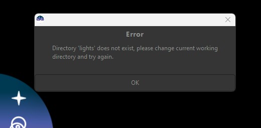

23:21:27:   File "C:\Program Files\Siril\scripts\Naztronomy-Smart_Telescope_PP.py", line 749, in <lambda>
23:21:27:     command=lambda: self.run_script(
23:21:27:   File "C:\Program Files\Siril\scripts\Naztronomy-Smart_Telescope_PP.py", line 850, in run_script
23:21:27:     self.spcc(
23:21:27:   File "C:\Program Files\Siril\scripts\Naztronomy-Smart_Telescope_PP.py", line 472, in spcc
23:21:27:     self.save_image("_spcc")
23:21:27:   File "C:\Program Files\Siril\scripts\Naztronomy-Smart_Telescope_PP.py", line 400, in save_image
23:21:27:     self.siril.cmd(
23:21:27:   File "C:\Users\X570 Aorus Elite\AppData\Local\siril\venv\Lib\site-packages\sirilpy\connection.py", line 1094, in cmd
23:21:27:     raise SirilError(_("Error in cmd(): {e}")) from e
23:21:27: sirilpy.exceptions.SirilError: Error in cmd(): {e}
Edited by Airstrike, 03 June 2025 - 05:49 PM.
#18 naztronomy
naztronomy
  • Posts: 159
  • Joined: 11 Dec 2021
  • Loc: Boston
Posted 05 June 2025 - 08:32 PM
Airstrike, sorry, I didn't see your response earlier. I would have sent you a link to try the beta version of the script.
The newest version of this script is officially part of Siril's script repository so it's easier to install and comes with a few enhancements and bug fixes.
Watch the full demo here: https://www.youtube....h?v=HVHnaRuaLDk
Give this a shot and let me know if that works better for you.

#20 Airstrike
Airstrike
  • Posts: 114
  • Joined: 15 Feb 2023
Posted 07 June 2025 - 02:14 AM
all good thanks naz :) brilliant update matebow.gif
