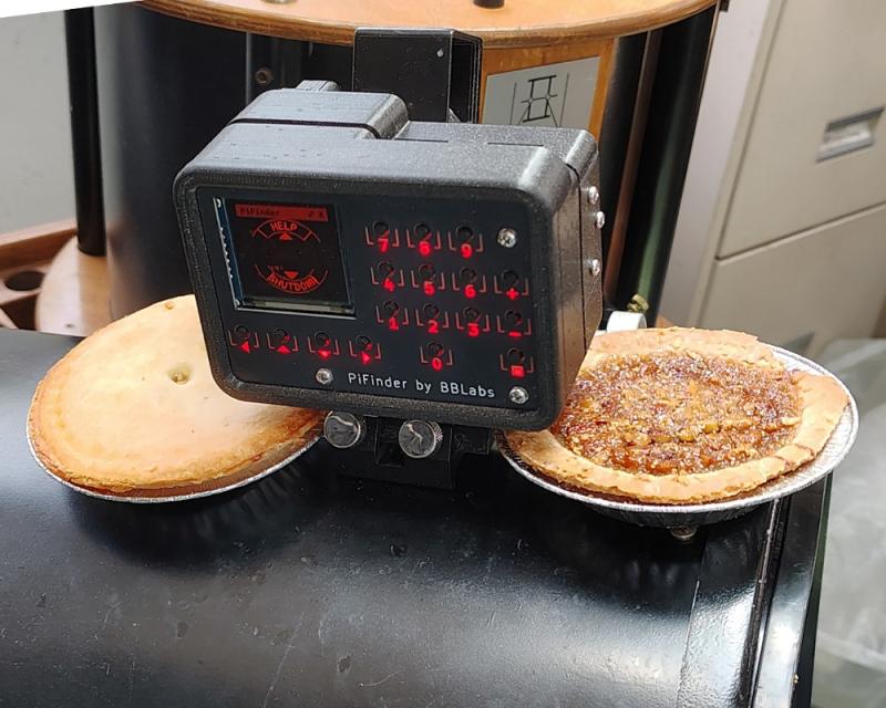

And for anyone who doubts the PieFinder really works as advertised...
