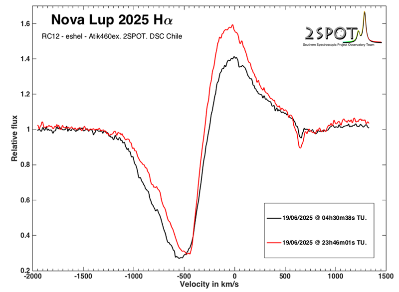

A spectrum taken from Chili with our 2SPOT setup (Echelle spectrograph R=11000 + ATIK 460Ex CCD camera and a RC 12') : 5 x 1200 s
And a detail on H alpha line to estimate the ejecta velocity
A raw echelle spectrum

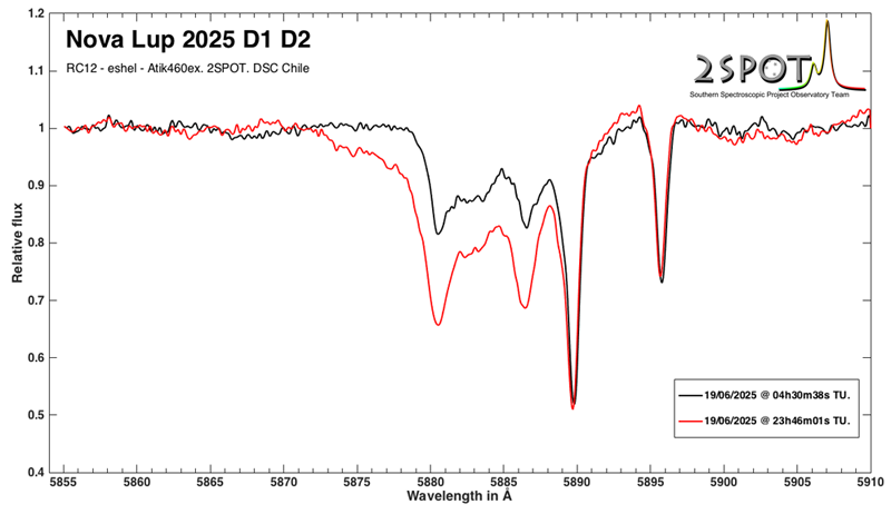

Evolution of this nova in one day on H Alpha and sodium lines
  • KShank, bunyon and Foc like this

And the evolution of the D1 D2 lines and the Helium I 5876 line
Nova-Lup-2025-D1-D2-He-I-evolution-20-sp
